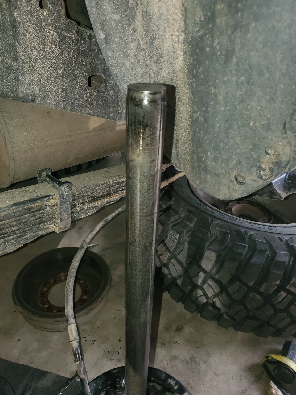

    Passenger side axle out ....splines missing??20220118_163124.jpg 20220118_163119.jpg

    Ouch. Def not what you should see. did you pull the diff too? If those are stripped on the inner good chance the diff is bad too.

    That's a broken axle, the splined section will still be in the differential. You will likely have to pull the other axle and diff to get the broken piece out.

    Well I'll be damned!!! I was wrong that's a first for me seeing that. Typically it's the gears that goes. So i don't know if that's lucky or unlucky. But do what @a2lowvw said also that'll give you a chance to check the gears and make sure they didn't get any damage.

    Thats a clean shear at the taper:boom:

    Bingo, the cleanest I have ever seen. No lip on the shear line or even a small ridge.

    Holy crap. And no particles when you drained the fluid? That's wild.
