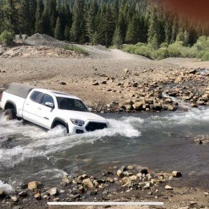

Did i drive thru water too deep? need opinions..

    Go measure that on the front and side of your truck and get a vision of what you are claiming.
    I'm betting no way it was that deep.

    Went back this morning with a tape measure and used the waterline stain on the adjacent building and the trailer tires to get an estimate. it was all drained out by then.

    Op should be fine. You can't compress liquid water so if any gets in the combustion chamber its a sudden stop and he'd most likely would have been towed.
    Hopefully there won't be a next time, but chances are there will be, so to add to the OP, start your water fording slow at 2mph and work your way to under 5mph. I've forded many flooded roads with my TOYOTA trucks and T4R(s) with water just coming over my hood and never an issue. Not wise to do, but I've been lucky.

    Hahaha, when I was there, the water level was really high and my truck was a few weeks old (stock). I walked halfway through with a stick and the water was up past my belly button and I decided that discretion was the better part of valor. I went around. haha.

    what length of time -duration of deep water immersion increases risk of damage to wheel and axle bearings on tacoma gen 3
    i had old ford ranger solid axle system that needed routine disassembly and lube after getting stuck in mud or water for short time. Needle bearings fell apart.
    Are tacoma grease locations watertight?

    you are good had a situation where it was nearly over the hood and I was still good to go. Wouldn't recommend taking it that high often but once every now and then is fine

    your good :thumbsup:
