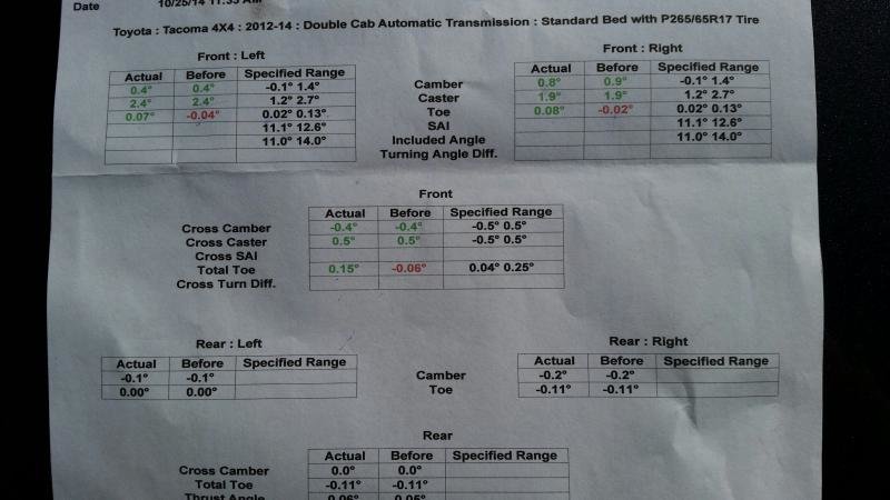

    I did get an alignment printout. This is what they gave me:
    I'm going to investigate the sticking caliper. Any tricks to diagnose this? Tomorrow is Sunday so I can play with it on my own a bit.

    That should pull right due to the alignment if nothing is wrong with your braking. A .5 degree is about the max cross camber and caster. I know it says it is still in spec,"green", but that does not mean it will drive straight. If your truck is bone stock they can get your caster and camber on the right much closer to the left, which is ideal caster. I like 0 camber, that is a personal preference. .1-.2 degrees camber is acceptable.

    I have noticed these trucks are inherently sensitive when it comes to the alignment. Even the slightest touch of additional camber or caster difference on them and they will pull very quickly one way. As far as your toe goes, I have also noticed that when adjusting these trucks for toe, they are very particular when it comes to the adjustment. It's not just loosen adjust and tighten. The machine will detect the small movements as you tighten and will knock the toe out again, at least it will appear that way, but it's really fine after you are done adjusting it and the vehicle toe will be nice and straight if you initially adjusted it to the correct position.
    Once they are adjusted correctly and within correct specs. they will hold an alignment quite well though, and for a very long time, even if you wheel it hard (ask me how I know). To touch on what another user said, your caster on one side is .5 of a degree different from the other and that will cause pulling very quickly. I had a similar problem even when the vehicle was new. I am wondering how well Toyota adjusts the alignments on these trucks from the factory. Or if they are doing it like Ford does these days and not even bothering in getting a perfect alignment from the start.
