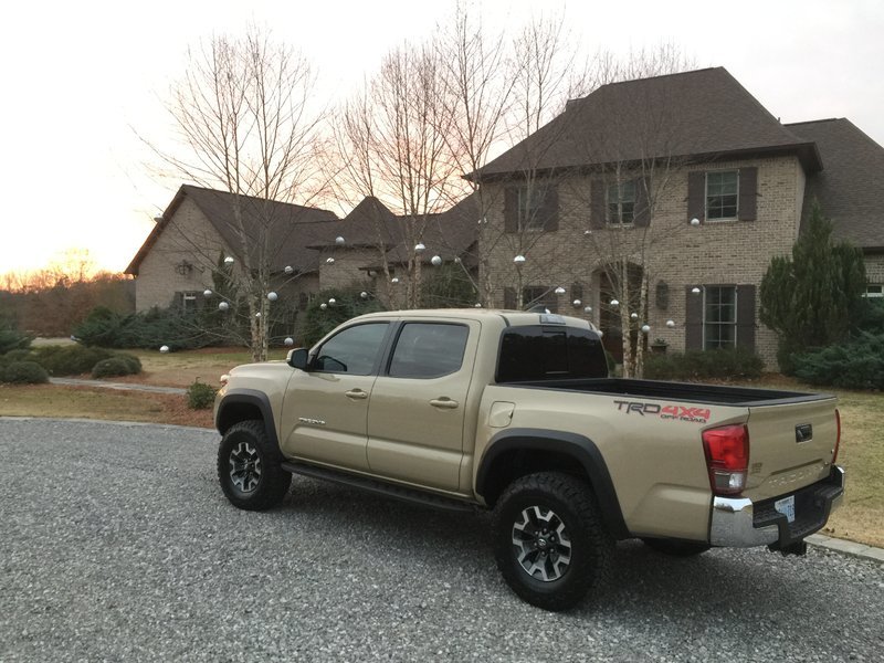

    I just bought a lift Monday which has:
    Front
    -Bilstiens 5100 3 inch adjustable pre-assembled
    -diff drop kit
    -Sway bar relocation bracket
    Rear
    -toytec long 2"AAL W/u-bolts
    -OME carrier bearing (I think that's right) drop kit
    -fox 2.0's.
    Pretty sure I have all my bases covered. I know UCA's are a great upgrade. But I tapped the budget ceiling this past two months doing the LED conversion, swapping and to KO2's, and scooping up some weather techs.
    Wish I had read more about 255/85/16's before I got the 265/75's I have now. But all in good time.
    Any need for bump stops, brake lines, or other precautionary upgrades? Toytec and fat bobs both said I should be good. I've read the what you need to know about lifting third gens, but it's a ton to sift through.
