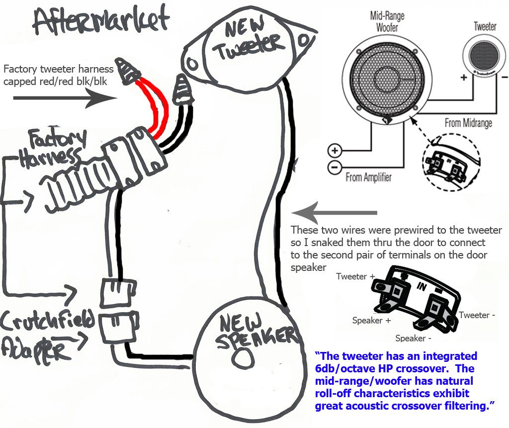

    Edit 1/6 - after I posted the diagrams below and read more // If you're just tuning in, I believe I did wire these correctly. I may have even been able to not cap off the factory tweeter harness since my new tweeters have internal crossovers. Ignore everything below saying the woofers had the internal crossover, they just have 4 terminals so you can send signal up to to the tweeters - again, I could have reused factory tweeter harness if I cut it where it becomes two wires and soldered to tweeter. I believe my error was reading all of the positive reviews for these speakers about bass, and expecting the setup to outperform stock in all ways. Since it's a mid range woofer (no clue what the factory one is but I assume full), I need to get a sub woofer and set my high pass filter up on my head unit. Then the mid range woofers and tweeters will be doing their thing crisp and clear, and sub (already ordered) will take care of the lows. I guess some people can get away with this setup if they have full range rear speakers handling the bass or something, but to just use this setup and nothing else will not sound as good as stock with any genre that has some deeper hits, even funk music. My bad, I'm an audio noob and didn't take 'mid-range' literally.
    Was warm enough today to install speakers, so got to it (already have a Pioneer dvd headunit installed which helped stock speakers immensely). Did the drivers side door first using Rockford Fosgate 6.5" components.
    I used a speaker baffle to get the woofer to fit and quickly DIY'd a mount for the tweeters reusing old bracket. The woofers have built in crossovers and Crutchfield only sent me a speaker adapter harness, so I connected the two wire speaker harness to a + and - on the woofer, and then connected the pre-wired tweeters to the other + and - on woofer. Again, tweeter was pre-wired by Rockford Fosgate, I just snaked wire down through the door and that was that.
    Remembering about that 4 wire factory tweeter issue, and someone's fix, I snipped the factory tweeter plug off and wired red to red, black to black, wire capped, done. Everything works, so I assume that's good. However, the lows sound like absolute diarrhea.

    Edit: sorry, the tweeter has the integrated crossover- quoted from product manual in blue text below

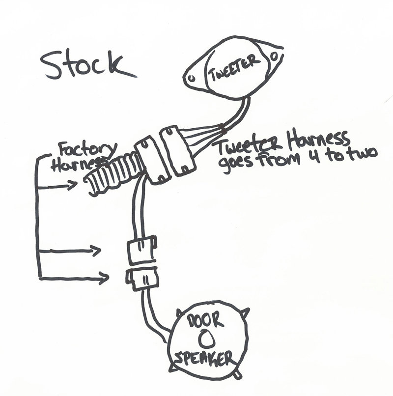

    K, sorry for big pix and sloppiness. I tried to do everything in photoshop but that was proving to be a little tedious. Anyway, first is stock diagram, second is aftermarket diagram. I capped off the stock tweeter harness red to red, black to black, because I heard otherwise the two wires running to the speaker (stock or otherwise) wouldn't get power because of how they wired it. My head unit has the following features that seem to affect things - Loudness - has Low/med/hi settings. It seems to make things louder, yes, but also shittier sounding. It's almost like these woofers can't produce the lower frequencies without sounding like dook. Bass boost - again, just amplifies the problem, the bass won't really go 'low', it tries, and makes noise, but sounds nothing like the same bass notes on stock speakers / my home stereo, like higher pitch more distorted version of the bass. High Pass Filter - When off, the bass is much louder, and also the crappiest sounding. When on 50hz, bass lessens, distortion lessens. As the HPF # increases, bass decreases, clarity is achieved.
    My desire and expectation was to be a bit better than stock, not shake like I had subs, it just seriously seems like these are incapable of playing music the way it was meant to be heard- almost necessitating the use of a subwoofer for the lows. I guess that's okay, I just can't figure out why so many people on Amazon with the same product said the bass is amazing if it can't do it.
    And how it currently is
    Manual states that the midrange has freq response 60-20kHz and the tweeter is 2.5kHz-22kHz
  7. Jan 7, 2013 at 5:50 AM

    Take 6.5 out, take head unit out, run a wire to 6.5 from head unit (out in open). Leave tweeter wired up to 6.5.
    Or
    (prefered method little less time).
    Leave the head unit in find the 2 wires in the kick panel and follow them thru door boot to inside of door(passenger side prefered, less wires to pick from and thru)find out the factory colors to the right front(i have the color diagram at home) and cut them before they reach the tweeter. Send them to the 6.5".Keep your wire you installed hooked from 6.5 to tweeter. This eliminates all of the harness's and twisting wires. See if this helps.
    If you need to fish a new wire thru door boots try using a large wire tie (12-16inches) with some hand soap or other lubricant that will dry and not destroy wires in the long run. Found this advice from Tacoma Worlds Audio Guru Mr. Marv article. This guy is good if you read any of his threads. Really knows his Tacoma's and audio. Hope this helps
