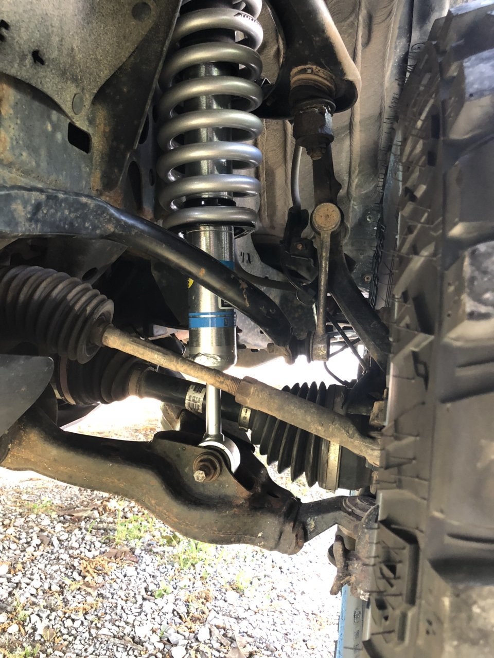

    loaderman82
    loaderman82 [OP] Well-Known Member
    Sep 28, 2010
    #43964
    600
    Dalton
    Flippin, AR
    2008 Off-Road
    Just got done taking out the spacers and dropping the shock to the next to highest setting. Looks a lot better. The uca is not touching the coil and my 305’s are fitting just fine with the cmc. Take more pics when it’s complete. F98FE348-C8DF-4700-BA0E-79B974CB5CDC.jpg

  9. May 13, 2018 at 11:29 AM
    #69
    loaderman82
    Sep 28, 2010
    #43964
    600
    Dalton
    Flippin, AR
    2008 Off-Road
    Now that I dropped the front, it’s 23 1/2 on the front and 24 1/2 in the rear.

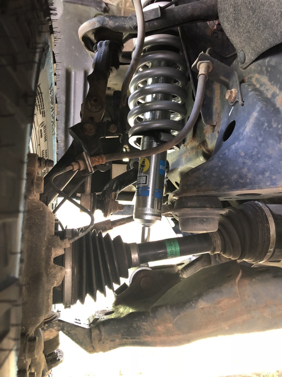

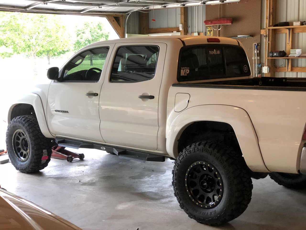

    loaderman82
    Sep 28, 2010
    #43964
    600
    Dalton
    Flippin, AR
    2008 Off-Road
    Does this look a little better?
    7B77D6F0-217A-410A-B520-80FCE91BF1AB.jpg 985B3CE7-C229-4E83-A11F-D2E4323B6FA7.jpg
    Slashaar, eon_blue and tcjacado like this.
  16. May 13, 2018 at 2:30 PM
    #76
    tcjacado
    tcjacado Well-Known Member
    Aug 29, 2016
    #195947
    41,586
    Yes, much better..... still close, but better.:thumbsup:
