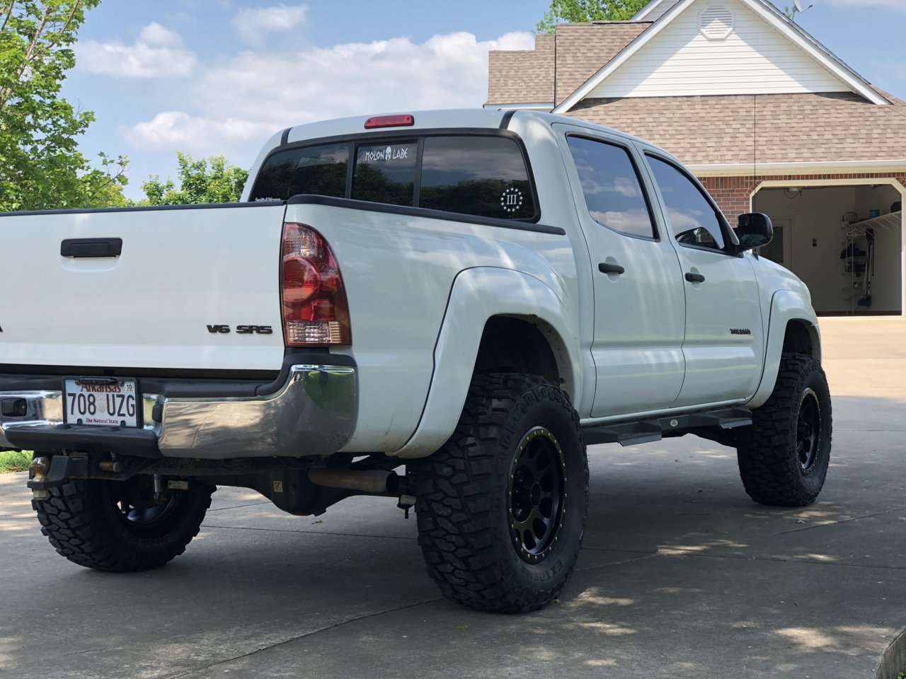

    Finished for the day! I’m in love!!
  4. May 13, 2018 at 3:17 PM
    #84
    tcjacado
    tcjacado Well-Known Member
    Aug 29, 2016
    #195947
    41,584
    Looks good
