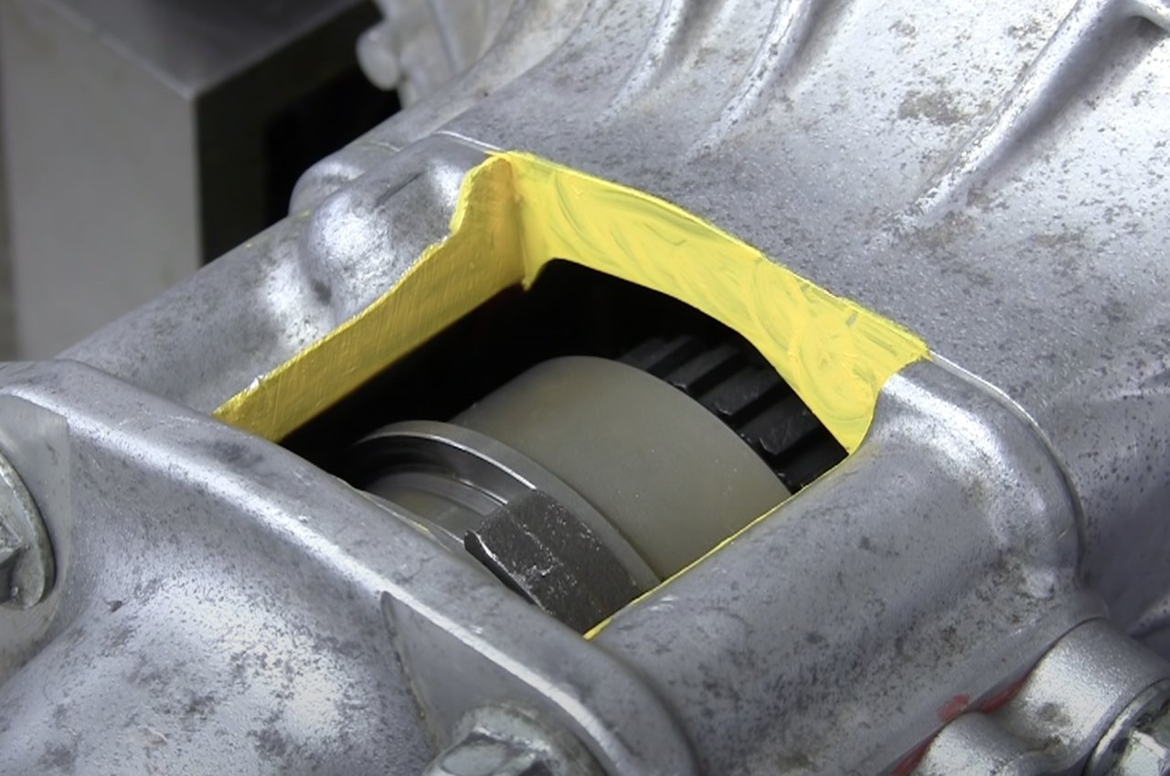

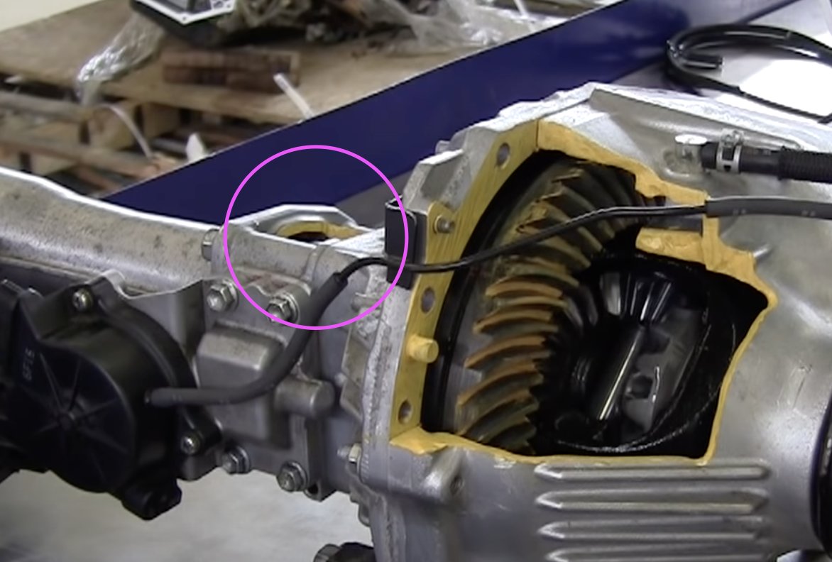

    malatx
    malatx Well-Known Member
    Jul 30, 2020
    #336090
    1,042
    2022 TRDOR DCLB Army Green
    I'm not really sure how ADD component is lubricated.
    I know the video there's no diff fluid, but under normal operation, isn't the ADD component constantly half submerged in diff fluid?
