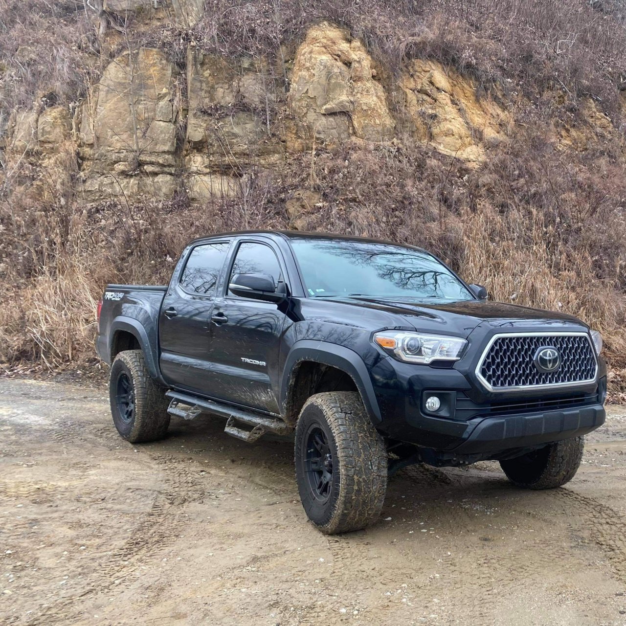

    Had quite a bit of snow recently. Got stuck. First tried to use just 4L. Spun the tires. Kept trying to get unstuck. RPMs got up to 5,000 for probably about ten to 15 seconds. That didn't work. Then tried Rear Differential Lock Button. The RPMs got up to 4,000 for about five seconds. Same result. Then turned it off and tried again with just 4L.
    It could be just my imagination running away with me, but I feel the vehicle is running differently. I believe I am detecting slippage when I press on the accelerator. It's not running as smoothly as before, and I believe the difference is noticeable.
    My two questions are, (1) Did I mess up the transmission by getting the RPMs so high and spinning the tires in 4L like a moron? And (2) what sort of diagnostic test should I ask the Toyota Dealership to run to detect an issue if there is in fact one?
    Bought 2018 Tacoma TRD with Off-Road package. Have owned it for three years. Put a three inch lift with LT 285/70R17 tires on the truck about a year and a half ago.
    Odometer currently at ~80k miles. Almost all very easy miles. I literally probably take the truck off road maybe once every six months for a couple of miles of moderately difficult terrain that requires 4H.
    Truck has been serviced according to recommended maintenance plan religiously every 5k miles. Vehicle has performed perfectly thus far with zero complaints from me.
    Thanks for y'all's help.
