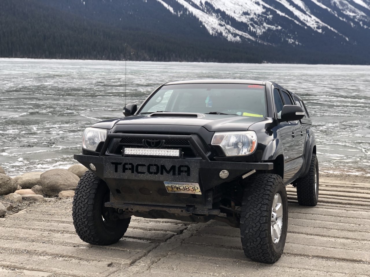

    Not sure but that's a kick ass bumper! Good luck
