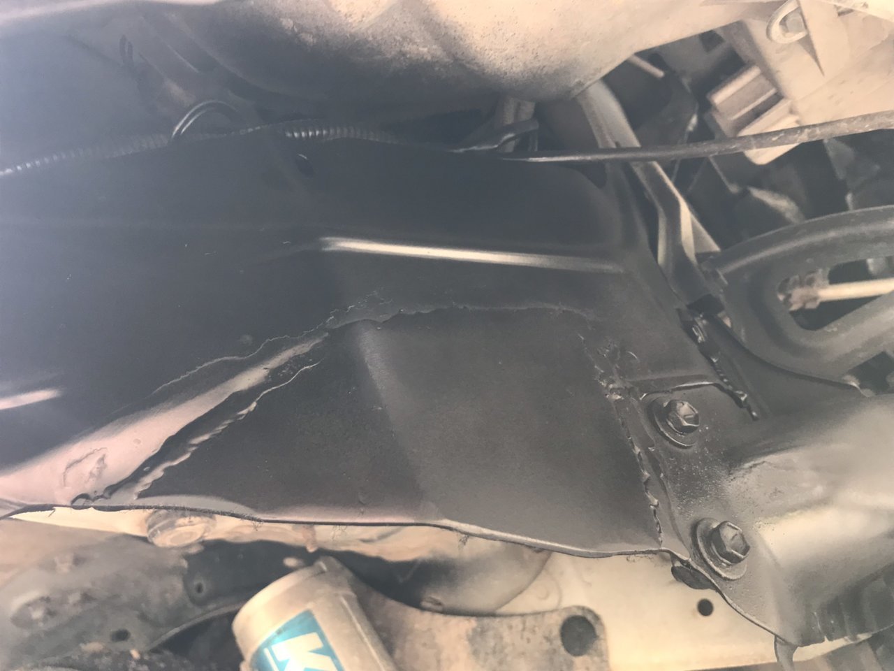

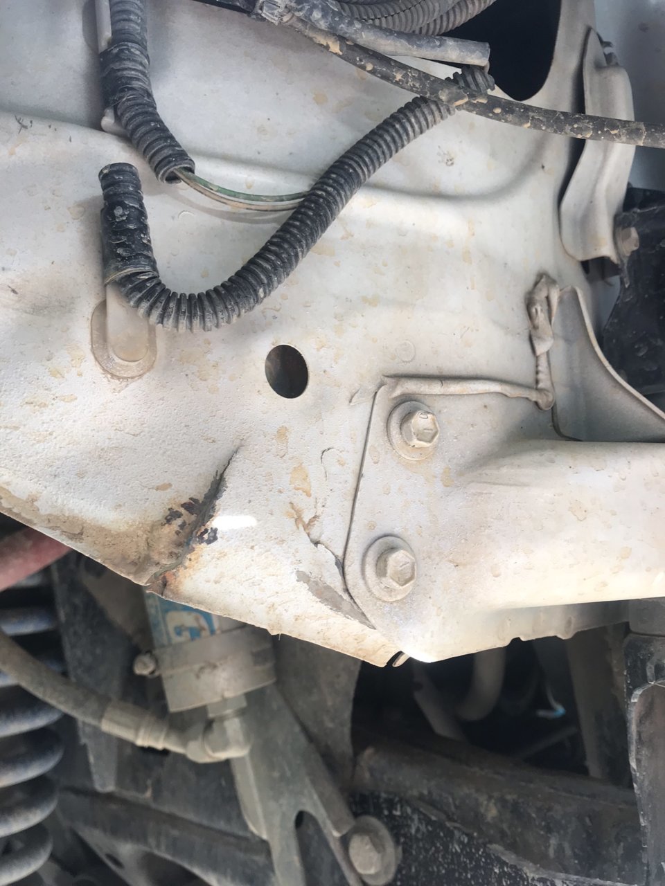

    Mine cracked with a 27F in it, if you go hard you don’t even need to put in extra weight. If you put in extra weight, you don’t have to go that hard.

    The one who dies with the most stuff wins.
    I love you Tacomaworld, but sometimes you guys just don't read all the things. I don't have a dual battery. In fact, a main reason I avoided a dual battery system was that I had heard of problems just like this from having the weight of both batteries in the stock location. I have one AGM in the stock location that weights 49 pounds. How much could the stock battery weigh? Forty pounds? If a nine pound difference is all it took to cause this, then the cause of this breakage was the wheeling I do, NOT the weight of the battery and the stock battery would have ended in the same results.

    That's where the model comes in. :D
    For this area, it is not hard to determine where the loads are coming from. The crack seems to be starting at the pressed contours and holes in the sheet metal. The reactions are at the cab mounts on either end of the wheel well. Take the R/F back to where the stresses are lower or the forming is more uniform and life should be good.
    This is done all the time in aircraft repairs. I am thinking that a good structural epoxy would eliminate the need for a big fastener pattern since it appears to be a stress / flaw issue versus a material strength issue. The fasteners would mainly be used to set and maintain the bond.
