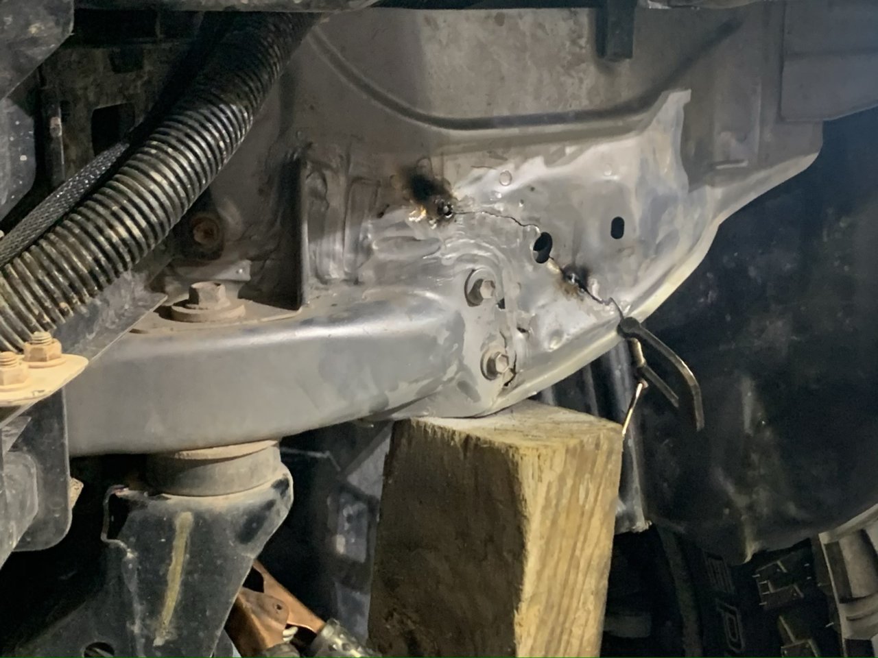

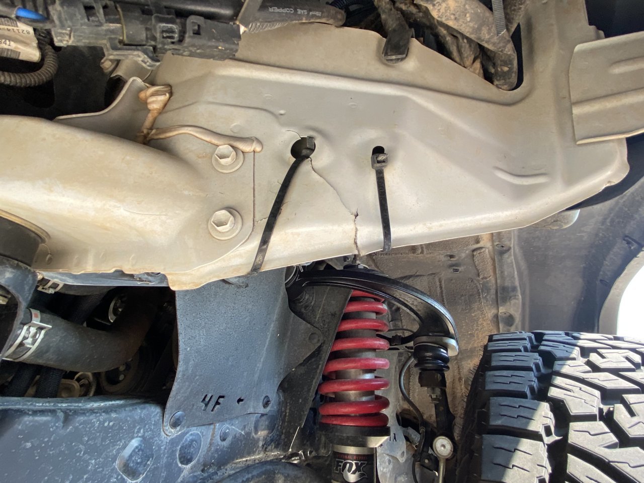

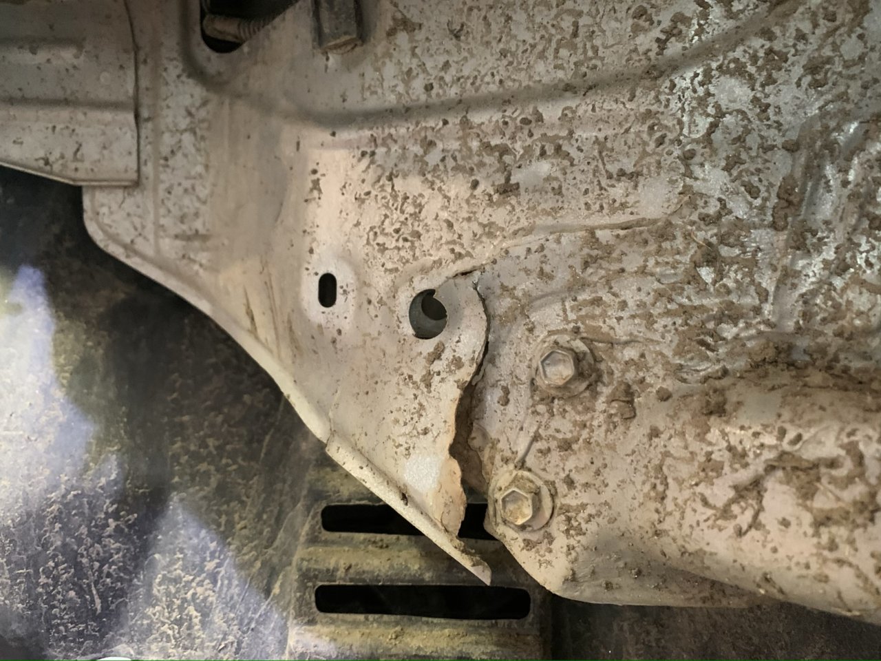

    My 2nd gen sh!t metal is also cracking pretty bad, mostly on the battery side. I don't have any extra weight up front, only running OME lift kit but my Taco does take the occasional high speed beating on logging roads... Curious to know if anybody has had any catastrophic failures because of the cracks? I'm still on the fence about trying to repair or simply let it "settle" until its cracked enough that the flex doesn't affect it anymore.

    stop drill the crack to give the metal some relief, otherwise the crack will continue to the end of the metal

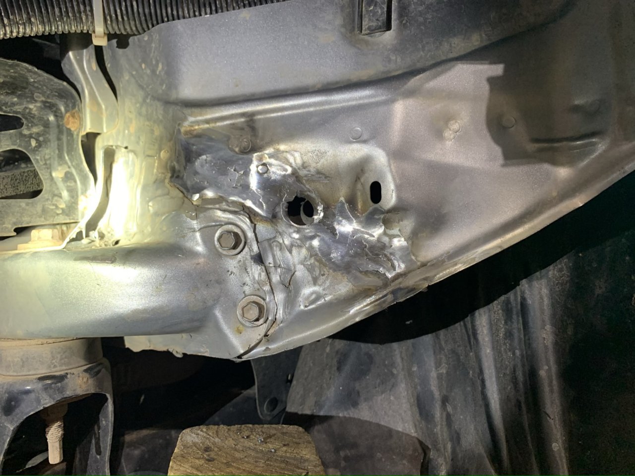

    Some updates. Today I took the bumper off to straighten out the break and weld it back together. I actually found that the passenger side was pretty busted up too. No "heavier" battery on this side, nor did it take any impaling from erroneous limbs on the trail. So while I have no doubt that the limb I hit played a major role in the damage I posted yesterday, I wouldn't be surprised if there was some breakages on the driver's side like there was on the passenger side even before I pushed into the limb.
    So with help from a friend who is a better welder than I, we straightened things out best we could, and welded the break. Is it perfect? No. Will it likely crack again in another spot? Certainly. But it seems that given the way I use the truck ("hard"), that even if I was to buy and install a new core support, it would only break again. The breaks on the passenger side prove that.
    So for now I am satisfied. I will keep an eye on things.

    That is actually a pretty damn good looking core support repair! That sheet metal is SO THIN.

    Yeah a lot of cursing was had as holes were burnt each time time

    Black '17 OR
