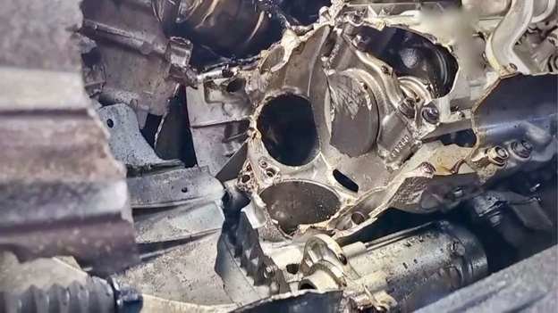

    I don’t buy the whole “engaging on concrete” thing. There’s all sorts of parts between those gears and the wheels but yet the case explodes like a hand grenade was in it?
    Something was installed wrong or defective, period.

    In 2wd typically only the spider gears and side gears are turning inside the carrier because the driver side CV is directly connected to its side gear and the resistance to rotation in the side and spider gears is much less than the resistance to free wheel the ring, pinion, driveshaft, etc. so the differential gears free spin. They are unconnected to any tractive load.
    The transfer case also has a gerotor pump.

    Nah, don’t sweat it this is not on you if things happened as you described, the TC is not made of glass.
    There are warnings in the OM on operating in dry pavement surfaces, but that is mainly because some people will totally disregard all cautionary prudence and throw caution to the wind.
    That being said, driving in the rain is not technically a dry surface, pavement can be slippery when wet, so if you feel the need, the need for 4ON4, that may be a safer outlet.
