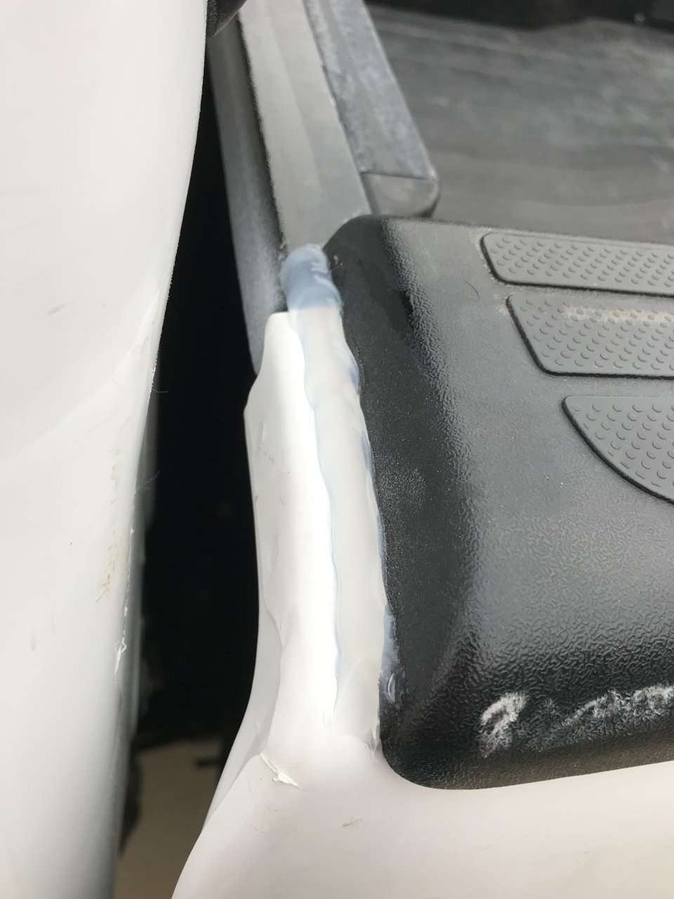

    I left the factory weatherstripping on it but now I wish I'd of removed it. It's now too thick on the front of the camper, under the front window area.

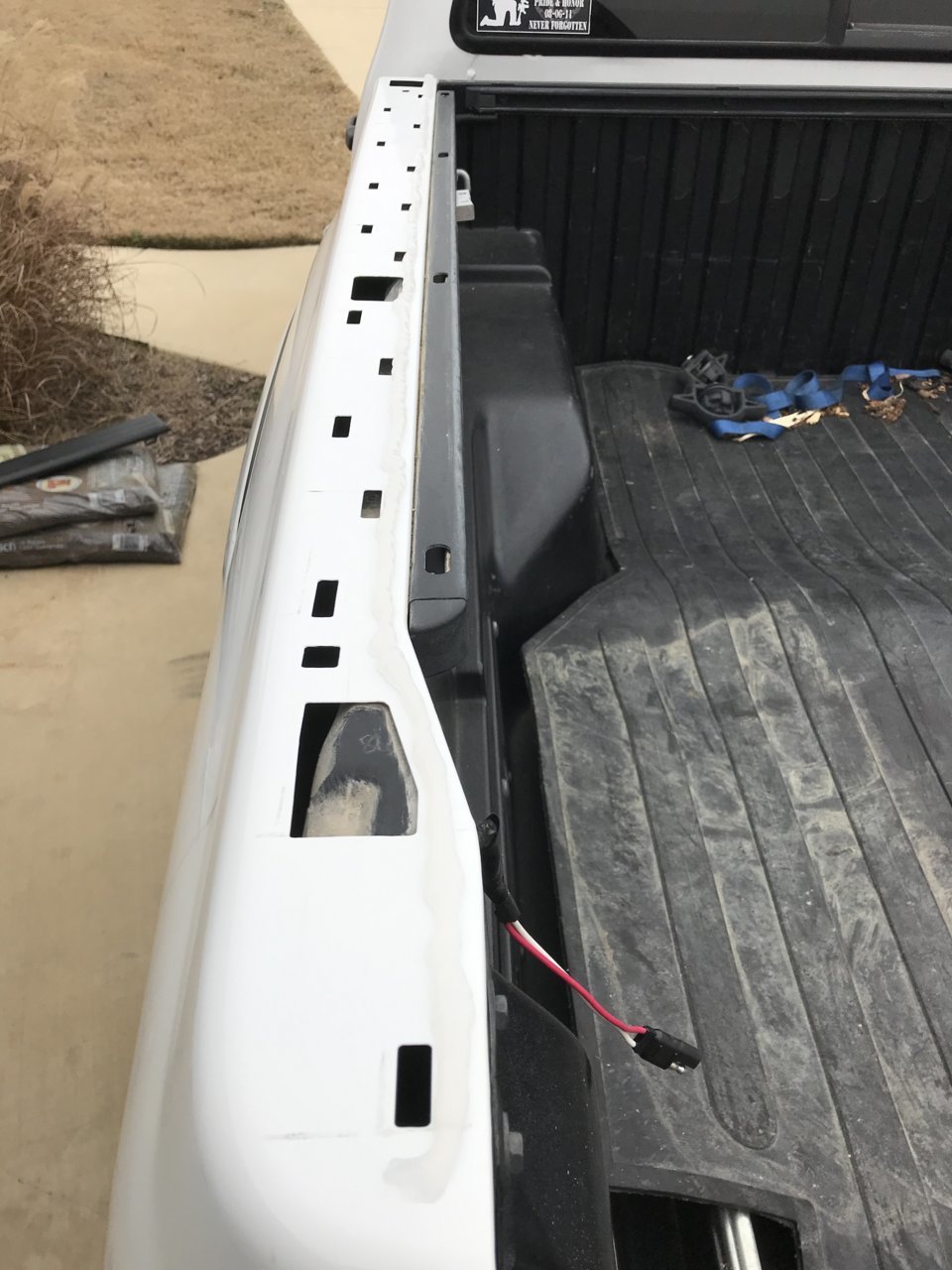

    First I removed the bed caps & made a thick bead of 100% silicone the length of the bed.
    After installing the cap, I did a bead @ the front of the cap. If I were to do this again, I'd of done it under the cap but it's almost invisible w/the camper on. 0EDBACB0-6564-44DF-B3EF-A08D926A271C.jpg

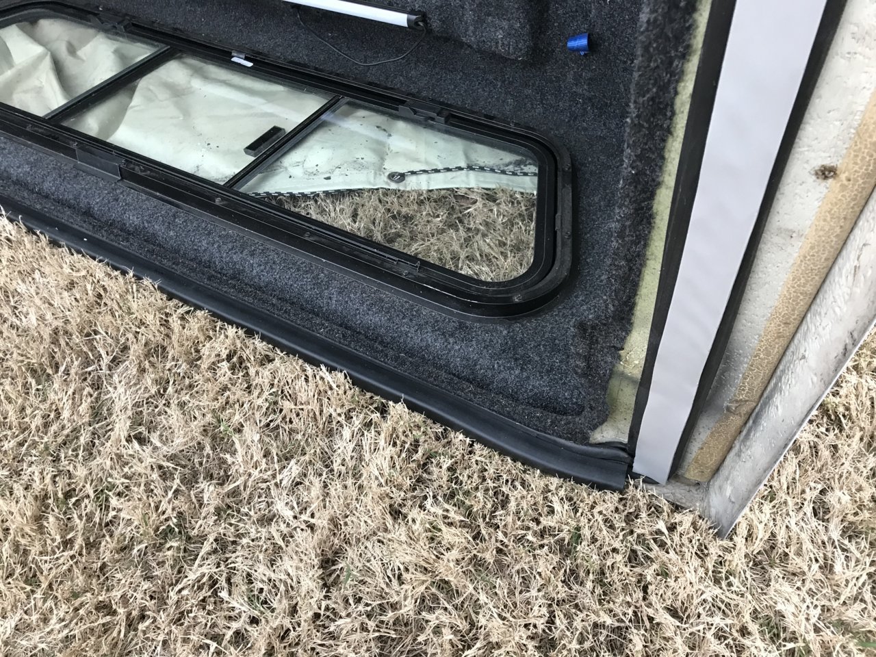

    Then I installed new weatherstripping along the sides. I got this @ Home Depot for $6 for 17'.
    Then I installed a really thick front gasket on the front. After installing, this stuff is too thick & the shell can't go down enough to sit properly. I'll have to lift the camper up & cut half of the thickness off.

    Great idea on the silicone, How hard was it to remove the bed caps?
  8. Jan 21, 2019 at 6:35 PM
    MolonLabeTaco
    MolonLabeTaco [OP] Well-Known Member
    Jan 30, 2018
    #242953
    2,786
    Dude
    N. Texas
    '12 DC 4x4 OR
    It was easy. A rivet type push clip, one on the inside of each 4 corners, then it pops up and out. I wouldn’t try to do it if it is really cold, though. I’d recommend 50+ degrees. The warmer the better.

    The front gasket I used was a little too thick. Try to find one slightly lower profile.
