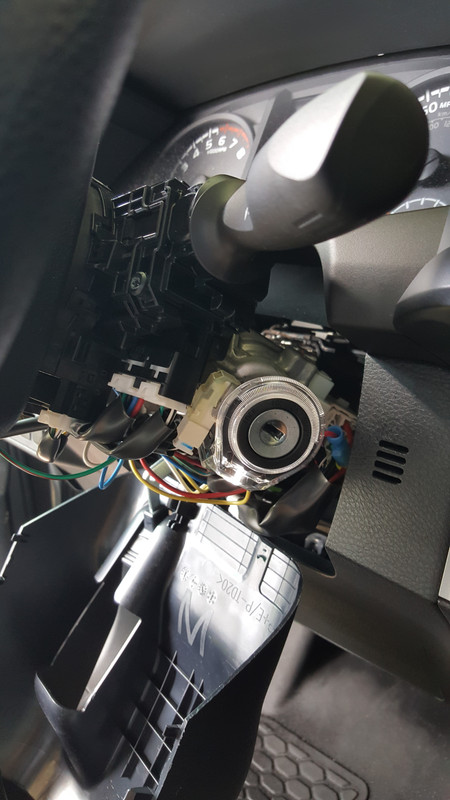

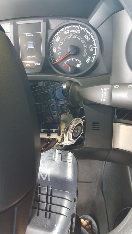

    I ordered the part through my local Toyota dealer and picked it up today. When I got home, I swapped out the parts. It was much easier than I thought it would be and it works perfectly.
    Some pictures below.
    Tools needed:
    A phillips screwdriver (I used an 11 in 1)
    Something to pry with (Again, I used an 11 in 1)
    Something to pick with (I used a pick from good ol' Harbor Freight)

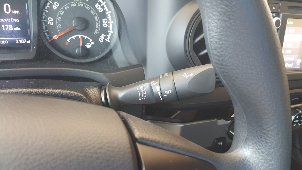

    Look at that terrible wiper control.

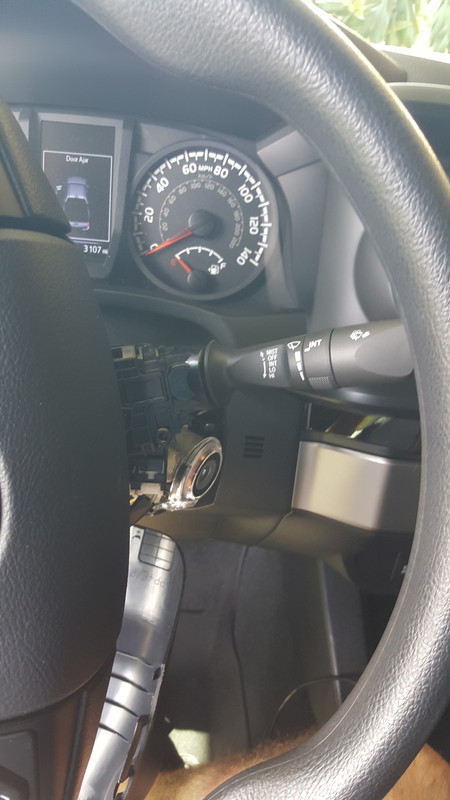

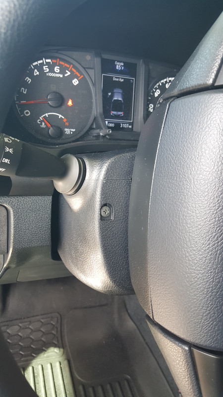

    I removed this screw.
    And this screw. That's it...two screws.

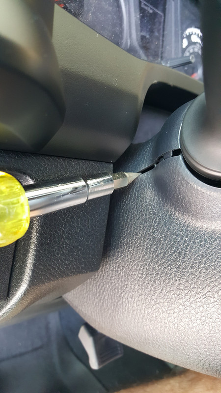

    I used my screwdriver to pry the cover apart.

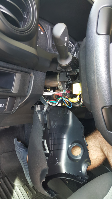

    I removed the top and let the bottom dangle between my legs o_O. Moving the wheel up and down was needed for clearance.
    See, nothing much to it.

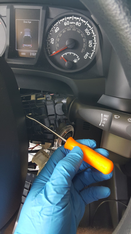

    A quick little push with my screwdriver and the plugs disengaged.

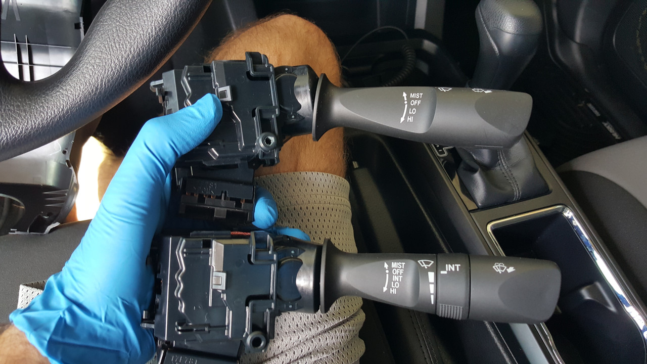

    A little pull on this clip with my pick while pulling the module to the right and it was out like a tooth.

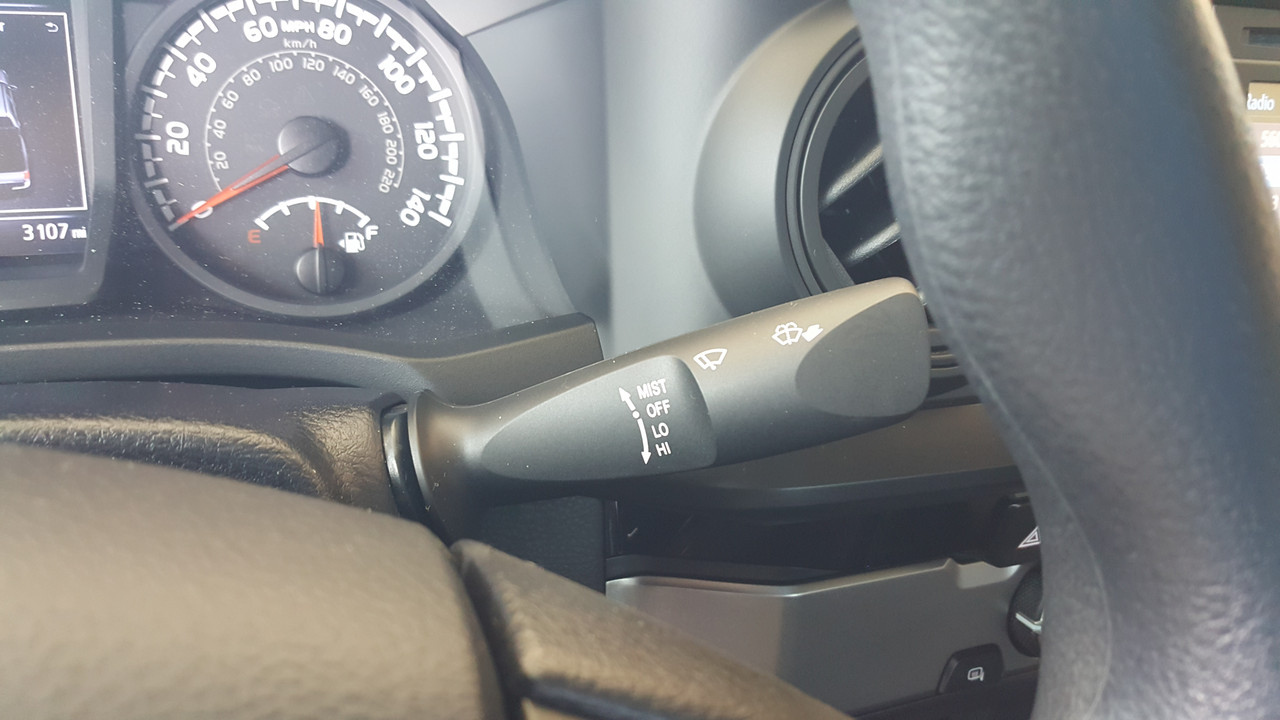

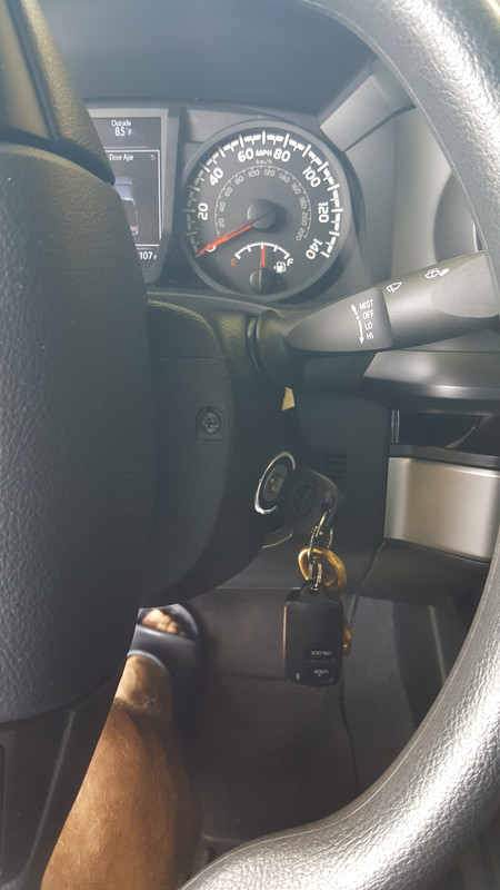

    The proper one snaps right in and the two plugs are attached. At this point, I tested the switch. It works!! Now in reverse order put everything back together.
    Look at that, like it was made for the truck.
