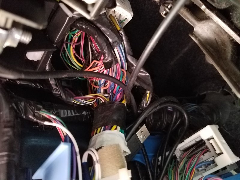

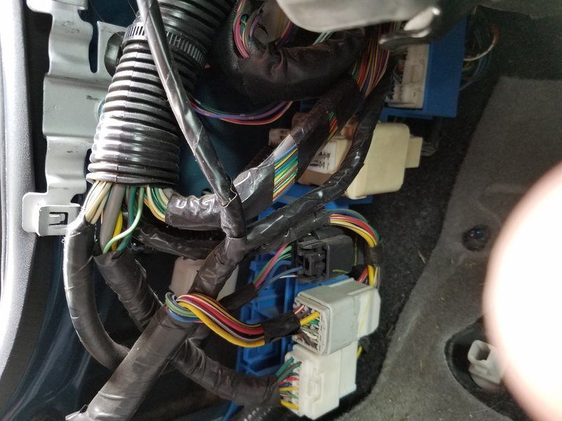

    Anyone willing to pull off their side panel and take a couple pictures of proper toyota wiring? looking to see a year around me, 2005-2011, thanks.

    yes, next to parking brake. i had to pull off my dead pedal, then pull of rocker plate against lower door seal, then you can twist off that black plastic bolt thing lol and snap the panel out of place, hopefully you've done it before if you're willing to help? Thanks

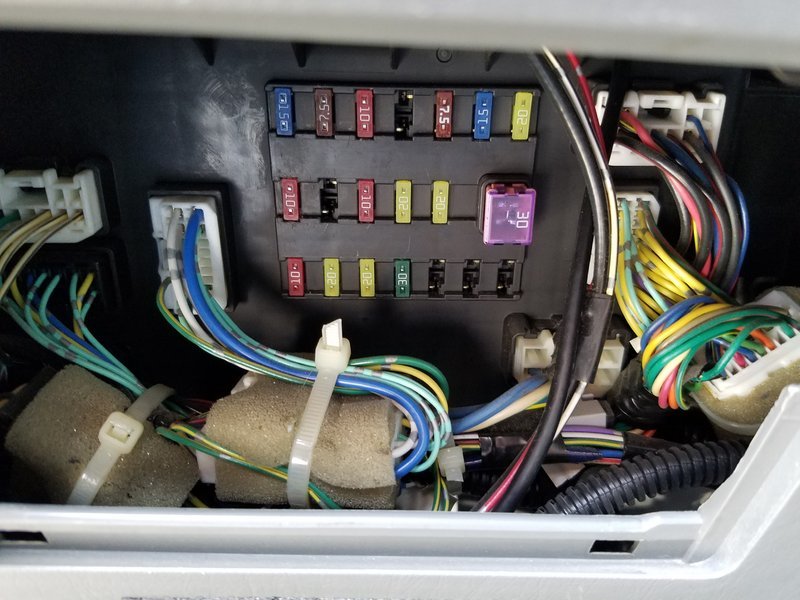

    This is my drivers side kick panel in my 08, just ran out and took them.

    The USB in the first pic is not factory. That goes to my speedo calibrator installed behind the gauge cluster. Everything else is bone stock.

    See thats what mine is suppose to look like, you do see in my photos I have plugs that are just hanging, nothing connected to them? or am I trippin? What did they do, I dont understand a single thing, how about behind the little plastic drawer, are any of your fuses spliced to anything?

    No splicing or tying in done at my fuse panel.

    What is that far right plug plugged into? I wish I had see this all earlier, this is scaring me a little, and I usually don't get scared lol. Truck was just out of service for over a week total for repairs, this is looking like a few week job... if it gets done. Probably gonna bring it to Toyota tomorrow and have them take a look first, problem is they charge $139 just for looking, maybe I can sneak by and see if they can look for free.

    Another pigtail (not really sure what it is or where it goes). They do that to make it easier to install and disassemble the vehicle by creating junctions in the harnesses. All of the plugs that are wrapped in the foam and have the zip ties are done that way from the factory and have been unmolested.
