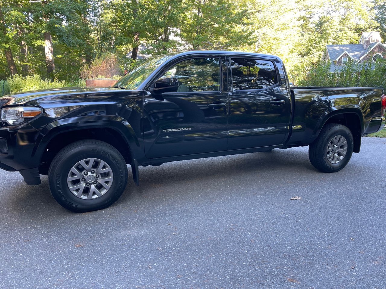

    FunkMasterFlex
    FunkMasterFlex [OP] Member
    Sep 14, 2021
    #377106
    15
    2018 Toyota Tacoma SR5
    Ok, just took it to my trusted long-time mechanic who's been taking care of my family's Toyotas for years. There is nothing wrong with the truck mechanically, it's in great condition. It's just the crappy undercoating, which he just basically said to keep an eye on and have it treated with fluid film every year regardless. Yes, at some point, it's going to start to flake/chip, but with the fluid film it will help mitigate rust (and in the meantime, I will keep researching for someone to actually have it removed, if po$$ible).
    Fuck it, I'm keeping this baby. I love it.

    MIDTNTACO
    MIDTNTACO Well-Known Member
    Apr 7, 2021
    #361952
    764
    Middle Tennessee
    2020 Midnight Black TRD Sport 4x4 DCSB
    That's the Taco Spirit! Congrats! It will all work out. Looks like a clean truck.

    Beerpayzdabillz
    Beerpayzdabillz Pastryatarian
    Jul 28, 2016
    #193169
    1,528
    Nor Cal
    2016 DCSB 4x4 sport
    Like a proud parent!! Love it.

    zoo truck
    zoo truck Well-Known Member
    Apr 21, 2020
    #325379
    8,948
    2020 quicksand sr5 tacoma
    None
    Nice looking truck, but imo, coating an existing layer of another type of undercoating as fluid film is asking for a mess....just ask a buddy of mine that sprayed cosmoline over fluid film at a later date. The two turned into a dripping, oily mess all over his driveway. I hope you never have to crawl under there for any future work if thats the case...let your ace mechanic handle it.
