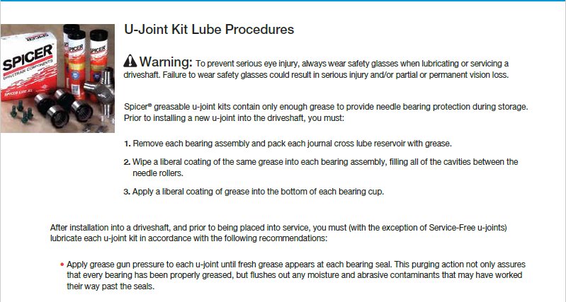

  16. Oct 17, 2019 at 7:52 PM
    #36
    0xDEADBEEF
    Mar 2, 2019
    #285037
    19,847
    2000 reg cab 4x4 flatbed MT
    Skydvrr likes this.
  17. Oct 17, 2019 at 7:53 PM
    #37
    computeruser6
    computeruser6 Nuclear Janitor
    Apr 1, 2015
    #152306
    1,965
    Dirk
    Escondido
    2008 Regular Cab Tundra
    King 2.5 coilovers Nitto Exo Grapplers
    There's the Spicer "Life-Series" (no zerk fittings/more seals and greased for the life of the joint) and the "10 series" (has a fitting and only one set of seals).
