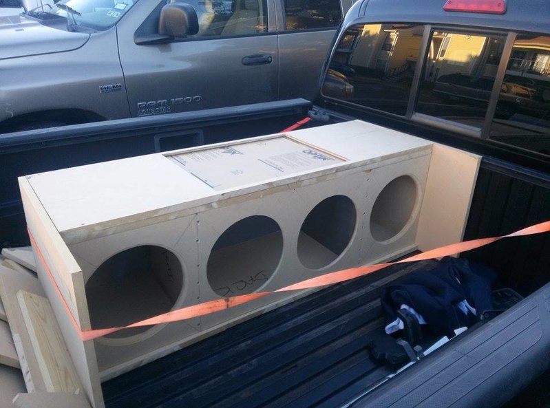

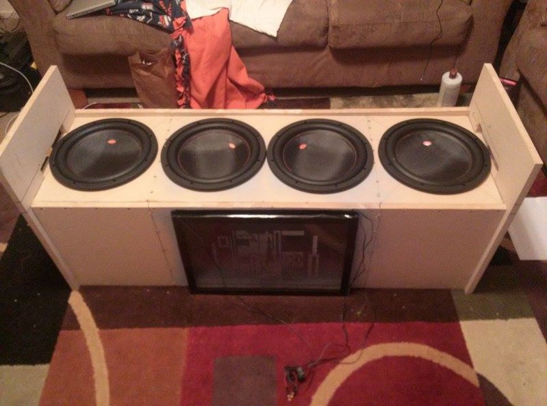

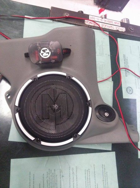

    So i did this between aug-sep 14 i figured i would share some pics before i rework the entire setup...Right now subs are down firing and she hit a 157.1db, thinking i'm going to do a wall next that's ported and try and get into the 160's
    Subs:
    2 x 16-PRX1.1000
    4 x 15-M512D4
    Highs/ Mids
    1 16-SRX4.300
    4 x 15-PRX1
    4 x 15-PRX62
    Deck:
    JVC NX7000

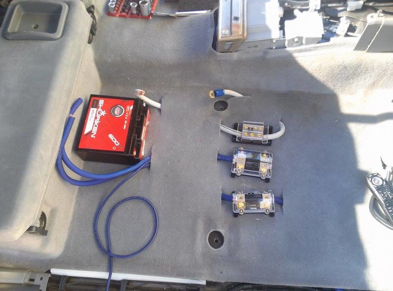

    2nd battery (pic with the fuse blocks) i need an alt, because there is a dip in the lights when both amps are on. normally i only run one

    first off nice setup
    I must say I'm shocked that your doing 157db with 4 15s and only 2000watts
    What meter did you use to get this verified ? is it a certified score ? Which sanction
    What size power wire are you using?
    Do you have your big 3 done
    Where are you grounding the rear battery/ amps
    Based on my experience with these trucks, you shouldn't have to many electrical symptoms with 2000watts worth of bass unless you have a high voltage drop due to resistance

    Yeah,
    ill try say this politely,
    There is no chance under any solar system it would reach 157 on a termlab or any meter competitions get certified with. With 157 on 2kw you would have a stack of records
    I'll try upload you a vid of what a tacoma looks like at around 145 db on termlab playing music. I had the roof solidly deadned and still
    Managed to seperate the roof cross Member from the skin.
    Burps where just under 150.
    Tacomas simply aren't as loud as other rides with = equipment. Their axtually quite hard

    Yeah I'm gonna have to agree with manethon. There's no way you're hitting a true 157db with that setup.
