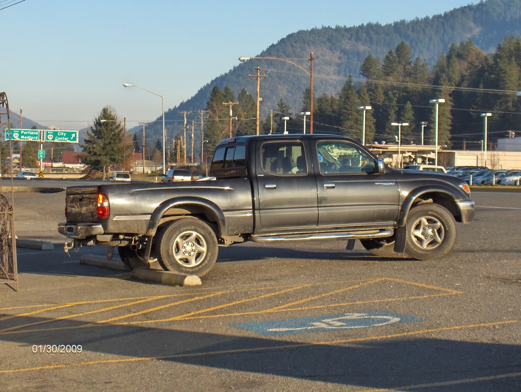

    I was driving home this weekend and spotted this Tacoma.......
    Did Toyota even make a 1st gen DC LB?!?!?!? I've never heard of or seen one before. Do you think it was somebody's Frankenstein project? Whats the deal?:cool:

    looks like a frankenstein project to me...
    AFAIK the 1st gen tacomas that were DCab only had 1 bed length...and thats not it in the picture

    i dont think its a chop
    but id question the frame integrity as i suspect its been lengthened somewhere in the middle

    As long as it was done correctly, the integrity of the frame shouldnt be an issue.

    Definitely a frankenstein project. I am thinking the dropped the longer bed on after extending the frame. Double cabs didn't come out till 01-04. The would have had to extend the drive train also.

    its an 01-04 either way
    the taillights changed in 01 too...and those are 01-04 taillights...
    im just wondering why? :confused:

    Extending the drivetrain is nothing more than just getting a longer drive shaft. Then, Lengthening the electrical wireing, and brake lines. Generally, when a frame is lengthened, they cut it between a crossmember, and reinforce it with plating.

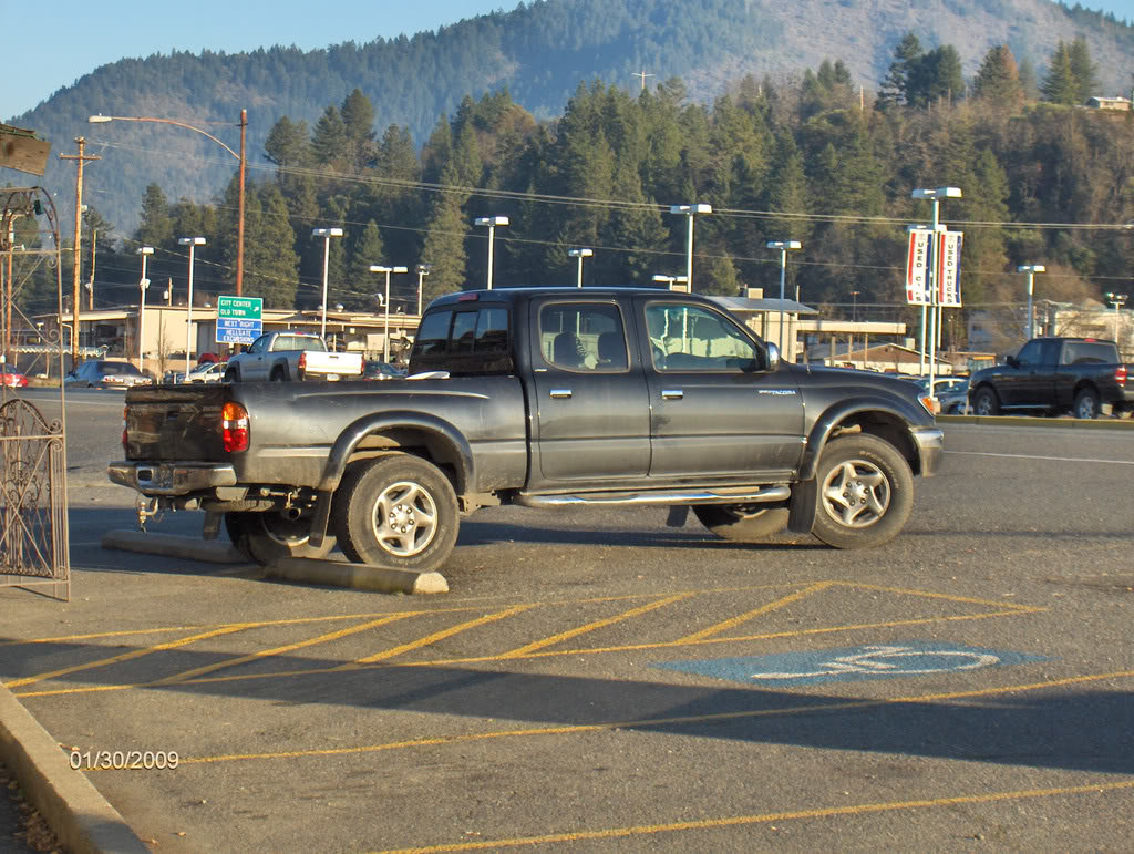

    Yeah, guess I shoulda snapped a few undercarriage pics. It was right in front of a business that was all windows in the front though so it probably would have looked a bit funny seeing some guy on the ground and under their truck. They probably woulda thought I was trying to steal their Cat' or something.
    I just pulled over to mess with my ipod adapter and went "wait, that's not a regular DC SB!" and grabbed my camera real quick. Maybe it'll be there the next time I drive through that town..... I'll get more pics if it is.:cool:
    Here's one more slightly different shot

    I agree - there's no way that's a stock 'production' frame. The wheelbase has obviously been lengthened.
    2001 - 2004 XtraCabs and Double Cabs had the same wheelbase, so this isn't some result of a Double Cab cab swap.
    If Toyota ever built any one-off long bed Double Cab prototypes prior to the 2001 DC model introduction, I've never heard of it.
