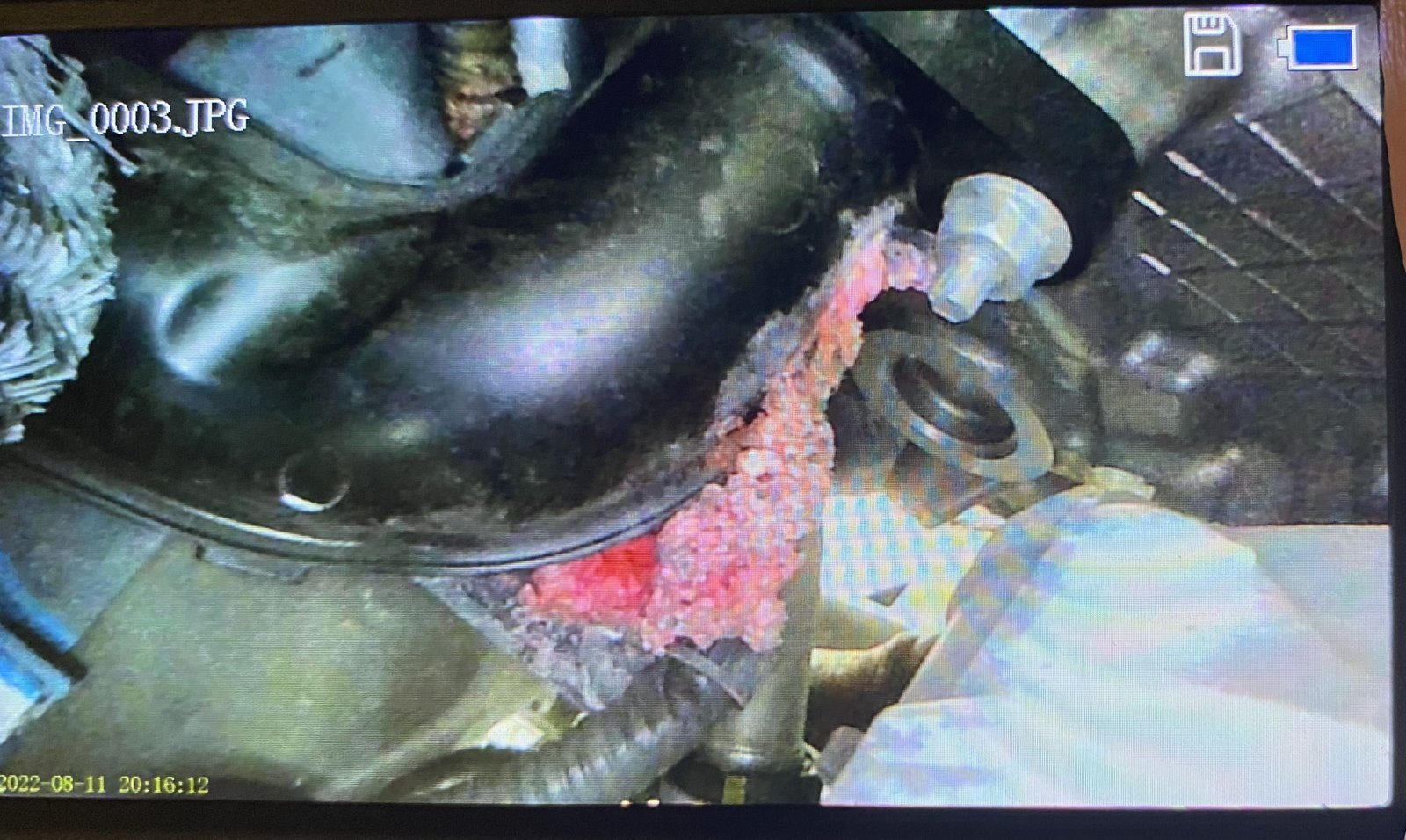

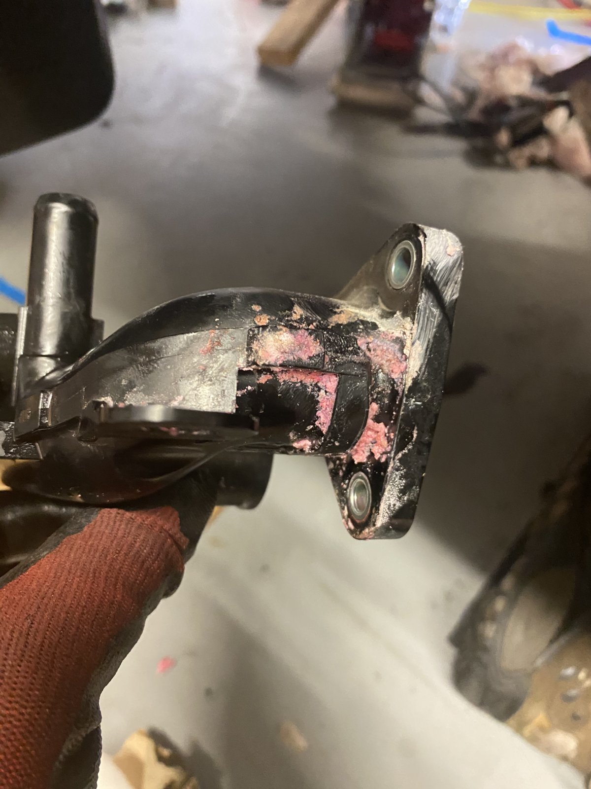

    Early 2016, bought new, leak at 90k.
    Sure it’s not an issue until it happens to you. I pulled the transmission and replaced it… was leaking at a seam line in the pipe from the molding process (I presume friction welded). This is in addition to a leaking AC evaporator I had to replace. Shame on Toyota.
