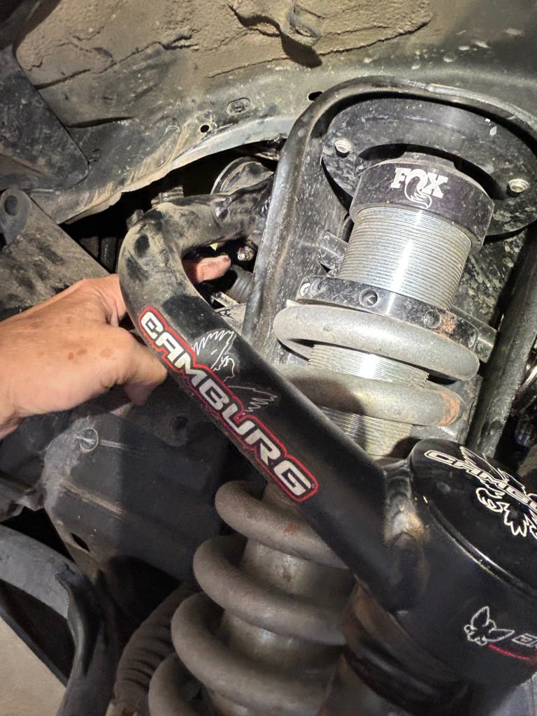

    X-Joint is under this Cap--Use Lithium based grease at zerk fitting after removing cap with screwdriver/hammer.

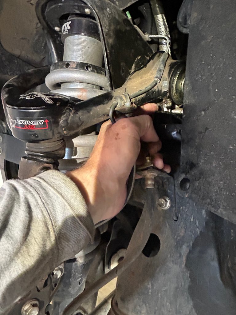

    Camburg Front Bushing (at the end of my finger)--Use Teflon-PTFE Grease at zerk fitting
    Camburg Rear Bushing (at the end of my finger)--Use Teflon-PTFE Grease at zerk fitting
