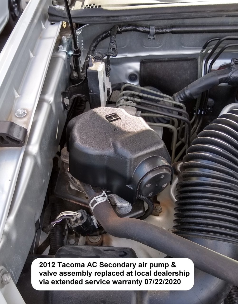

    TacTuna
    TacTuna Active Member
    Jul 3, 2019
    #298160
    42
    Charlie
    2012 Tacoma Access Cab V-6 4X4
    Per my service advisor this morning, corporate is recommending the pump, housing and valve assembly all be replaced. Like Grizquad, they gave me the cover for it also at no charge. Mechanic made a comment, "like the hood struts!" A nice entry into the vehicle folder.

    What's the new filter look like?
