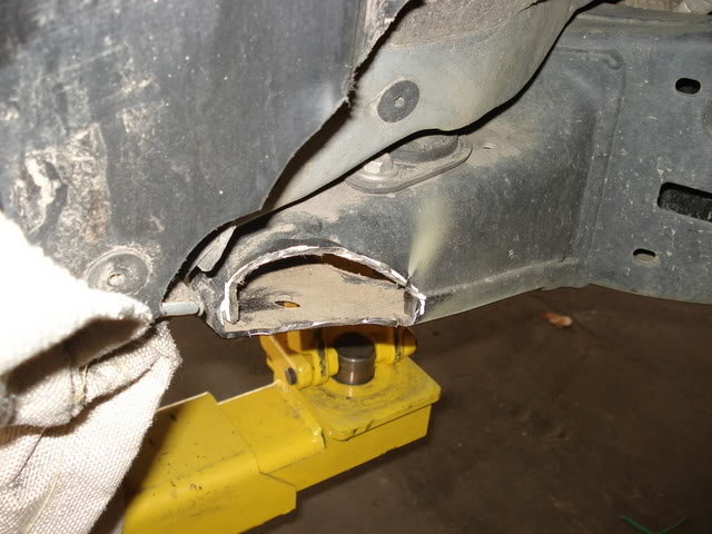

    Here's a picture: This is "TACOSALAD" over at TN
    Good Luck!

    That looks great! I know Demello will do a great job, they will keep the factory look.
