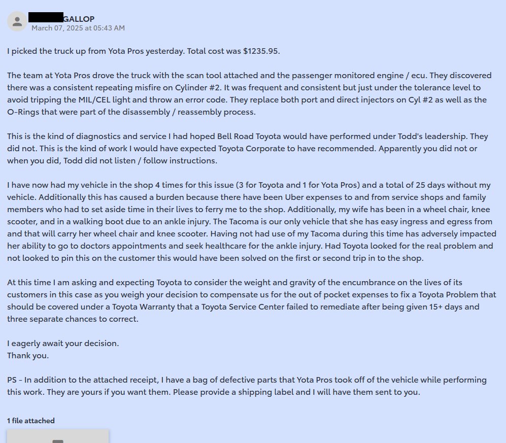

    Posting here so I have it for documentation later if needed but also for your thoughts and opinions.
    I'm the guy that has been crabbing to Toyota that a bone stock 23 should be getting better than 13 to 16 MPG. Something is off. Toyota won't even consider looking at it. Camelback Toyota said they would look at it. Then disconnected my dash cam and told me "well there aren't any codes."
    Then today I start it up, drive off and make it 1 mile from the house. Engine shudders and dies in traffic and while moving (mild acceleration ad at about 14 to 20 mph). I stop in a busy street. Throw on the hazards, put it in park, restart. The truck shudders but goes into drive and is in limp mode. Couldn't do more than 18mph. The infotainment screen caught a message about the engine and or transmission harness.
    I parked it at home and took the wife's car to make my appointments. When I got home, I went on line to get a service appointment lined up. None of the dealerships near me (N. Phoenix) can get me in until 2025. Hoping when Bell Road Toyota gets in on Monday they call me and tell me they can see me sooner.
    ADDING FINAL TOYOTA DIAGNOSIS:
    ADDING FINAL YOTA PROS (Independent) DIAGNOSIS:
    CONCLUSION:
    After discovering the voltage drop on the Fuel Injection System, Yota Pros honed in on driving the vehicle with a scan tool. Scan tool indicated a consistent misfire on #2 Cyl. Yota Pros replaced both Fuel Injectors on #2 and since then my MPG has gone from the 13MPG/15MPG range back up to the 19MPG to 22MPG range and the truck no longer dies in traffic. Root Cause - Defective Fuel Injector from the Factory. Toyota failed to acknowledge my MPG issues since early on (around 5,000 miles) and failed 3 for 3 times with an escalation to corporate to diagnose the issue - blaming the customer instead.
