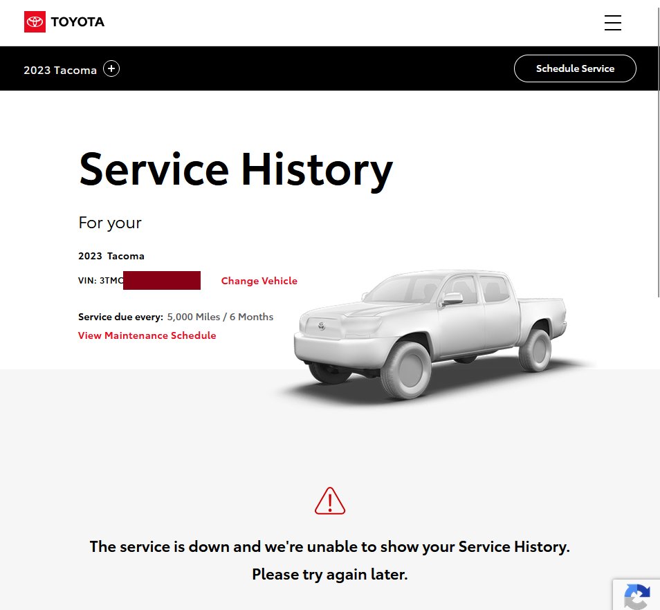

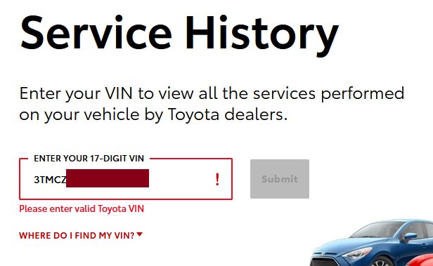

    Just had the promised call with Jennifer.
    Her tech had an e-mail exchange with Todd and the tech and agrees that electrical systems are sensitive and this would not be a warrant-able item but that there is no permanent damage and thus no repair needed - just don't plug anything into the ECU fuses. I explained that it wasn't plugged into an ECU fuse - it was in Slot 23 and I have removed that wire and the radio. Still only a few miles in but fuel economy under favorable conditions (55 / Freeway / Level Ground) shows it not coming up. Stays around 13 to 17. We discussed the lack of any documentation and that I still have no clue about what was performed and I still don't have this picture he's looking at (have seen it so I know it exists). Jennifer pointed me to the Toyota.com Owners section. I have an account there already. She said I could pull up my service history. She's still looking into this and may have me go to another dealership but said that Todd's notes will follow the vehicle so unlikely they will find anything. She wants to dive deeper with her tech to understand this better. I told her that I appreciated it but from here out any work they do or anything they find is purely bonus info. I'm not relying on Toyota any more.
    Validated the VIN is correct (redacted). So no idea now.
    I'm at the end of a tank so I'll fill up and we'll see what that tank does for a better reading. Also going to unhook the battery for an evening and then see if that helps reset the mileage calculator as mentioned above. Maybe it works?

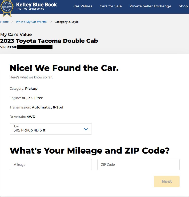

    Vin pulls up fine on KBB.com

    Sometimes that portion of Toyota's website has issues and does not recognize VINs. Try it again tomorrow. Happened to me when I waa shopping for my truck and pumched in VINs from dealer's websites to see detailed configurations.
    Changing browers sometimes worked.

    Just curious, did you click on “create account” to get to where you are (entering the VIN)?

    I already have an account and can see where they tracked my vehicle up to 11,000 miles (with 46% fuel remaining) - Is that not the same account?

    Looks like it's letting me in a little further today?
