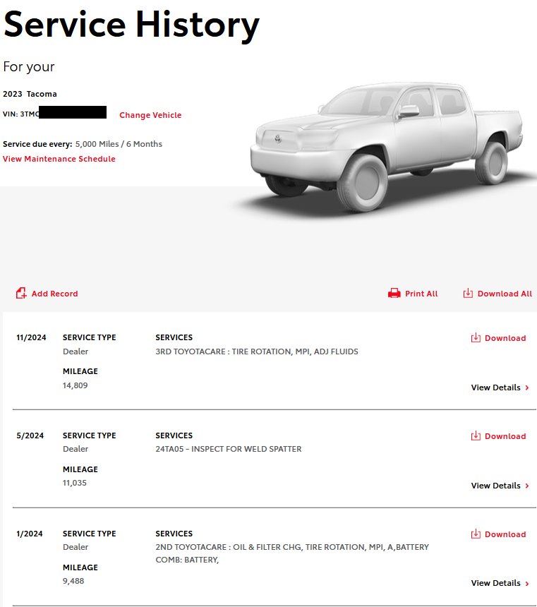

    Well now! This gets good! The Toyota page that shows my vehicle service history is up!
    There is NO RECORD of either trip to Bell Road Toyota recently for this warranty issue.
    Yet we got proof here in this chat because I have the chats with Toyota and the E-Mail from Todd. Now I'm even more worried than before. Da hell are they hiding?
    Barsoom likes this.

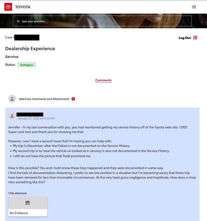

    GT GALLOP
    January 27, 2025 at 01:22 PM
    Jennifer - In my last conversation with you, you had mentioned getting my service history off of the Toyota web site. I DID! Super cool tool and thank you for showing me that.
    However, now I have a second issue that I'm hoping you can help with.
    • My trip in December, after the Failure is not documented on the Service History.
    • My second trip in to have the vehicle re-looked at in January is also not documented in the Service History.
    • I still do not have the picture that Todd promised me.
    How is this possible? You and I both know these trips happened and they were documented in some way.
    I find the lack of documentation disturbing. I prefer to see the positive in a situation but I'm becoming weary that these trips have been removed for less than honorable circumstances. At the very least gross negligence and ineptitude. How does a shop miss something like this?
    1 file attached
    • No Evidence

    I'm just copying the words after I hit submit in the portal. That way it's searchable text.
    Here's a screen shot of the portal
    Barsoom likes this.

    I did just get the missing reports from Toyota. They still don't show up in the Toyota Owners section but I had Toyota Corporate send them.
    Haven't had a chance to look in detail (it's a lot of pages grided off and I've been at work) but the 4 things that stand out to me are:
    1. Cleared codes
    2. Inspected floor mat
    3. Drove Truck
    4. Blamed Ham Radio
    No mention of even opening the hood that I have read YET. Again this was a cursory scan through the print real quick to see if something popped out. I'll post up the docs when I can.
