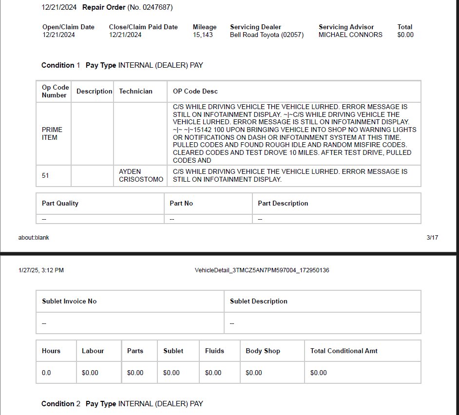

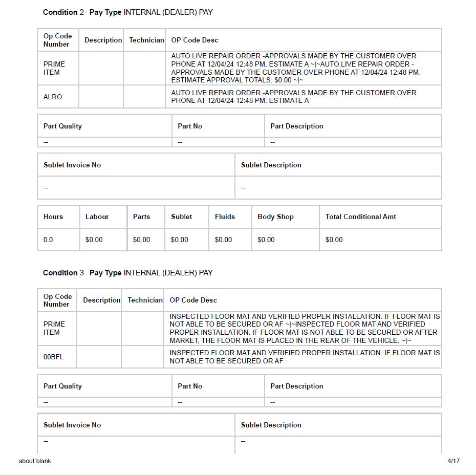

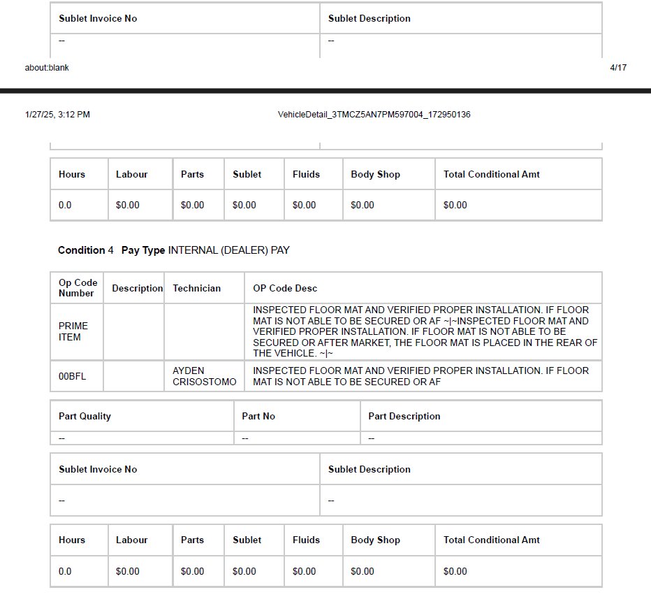

    Here are the Dealership Service Notes. Going Chronologically from the original complaint in December (it failed 11/29).

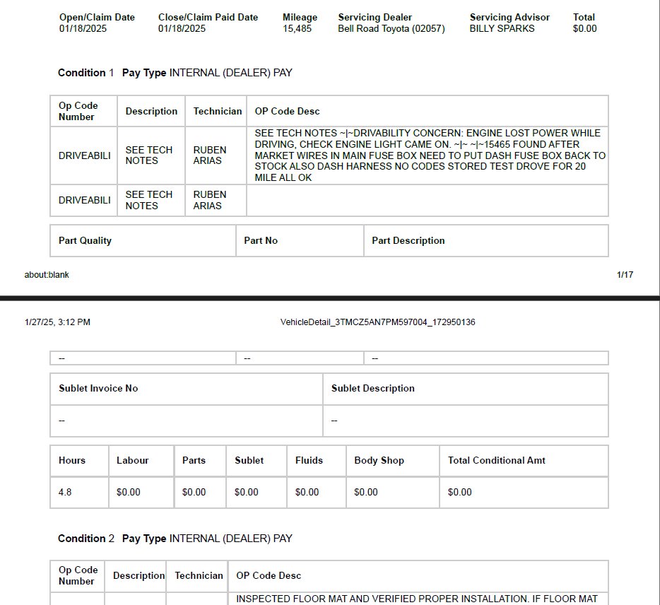

    Here are the most recent Dealership Service Notes after the complaint to Toyota Corporate.
    It's interesting that this one stats the claim on the 18th and ends on the 18th when I dropped it off for service on the 12th (Service Closed) and the "diagnostics" were done on Monday the 13th. Then it sat on the parking lot until the 17th when I picked it up and they closed out the paperwork on the 18th.

    It's interesting they they don't mention the specific codes, didn't seem to check coils and plugs. I escalated it to corporate and asked why they didn't check coils and plugs. Dropped it off for the second trip with a corporate complaint and asked if they were going to do more than clear codes and drive - like check coils and plugs. And after all that all they did was just blame the radio. I'd feel way more comfortable with the radio diagnosis if I saw some actual mechanical work. Nothing superfluous.
    Tell me if I'm crazy here but if I was the mechanic (and I'm not that's why I'm asking non-rhetorically) I would have checked:
    • Battery
    • Alternator
    • Spark Plugs
    • Coil Packs
    • Compression Test
    • Belt Tension
    All of that in addition to the fuse tap.
    Instead all I see is:
    • Cleared Codes
    • Drove to Starbucks
    • Inappropriately diddled the mans floor mats
    BTW - The floor mats go in for Therapy starting on Monday. Would appreciate your thoughts and prayers as they are in a dark place right now.

    The floor mat thing is due to the “unintentional acceleration” thing Toyota suffered through about 15 years ago.
    The determination was that improperly installed floor mats caused the gas pedal to get stuck. I had to bring my 2010 in for a recall to have the gas petal shortened.
    Now, every time you bring your vehicle into a dealer for service, they check the floor mats.
    In my experience, they are getting a bit more lax in this though. In the past I remember always finding my drivers side Weathertech in the bed of the truck. The dealer would not release the truck to me with the aftermarket mat installed due to liability.
