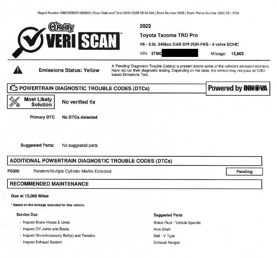

    Then this morning THE MUTHER FLIPPING TRUCK DIES IN TRAFFIC AGAIN.
    I go straight to O'Rieley and had the code pulled. P0300 Random Misfire. Looking that up it means P0300x is the cylinder. Where X specifies the cylinder that failed. But P0300 with NO X means multiple cylinders.

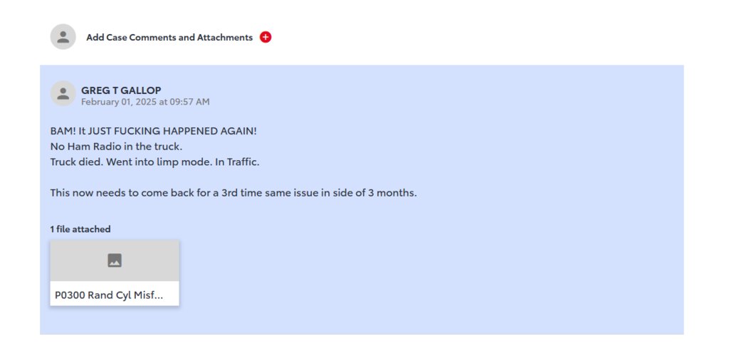

    So I Upload this... To my now CLOSED complaint with Toyota.
    I AM BEYOND SPITTING NAILS PISSED AT THIS POINT.

    Are all of the aftermarket electronics disconnected now?
    If so, this is a new issue, and should be treated as such (not reopened on the previous ticket). Is there another dealer within a reasonable distance? You just need someone to actually diagnose it, beyond pointing to a smoking gun like the fuse taps (whether or not they are relevant).
    Or just go to an independent shop while you still have the codes. O'Reilly's / AutoZone doesn't always see the full picture (and they're not qualified to diagnose either).

    Crank Position Sensor maybe? I've read several threads in the past that seem to have similar issues to yours. Dies on them, re-start and goes to limp mode. Then later some would start as if nothing happened.

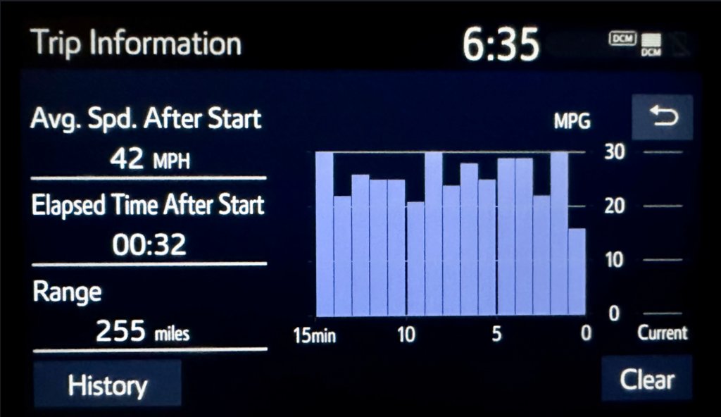

    your MPG is good, you need to relax on this. I get the same. The engine dying in traffic is the issue. Something to do with spark

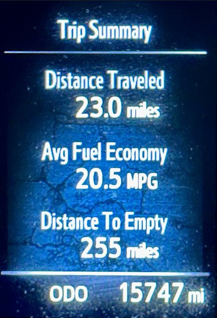

    Not trying to throw gasoline on anyone’s fire here.
    My 2022 gets worse mileage in the 70-85 mph range, roughly 17-18 mpg. If I take highways not interstates, I go 55-60 mph and get 22 mpg easily.
    Caveat:
    I drive under 2k rpm, most of the time, even accelerating and I stop equally slow.
    Not sure if this helps, but it probably doesn’t hurt.
