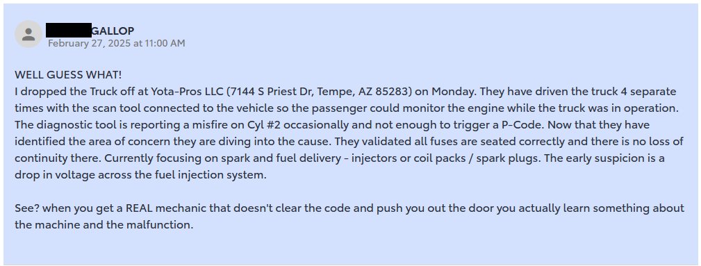

    I just got off the phone from Yota-Pros and updated my complaint in the corporate portal.
    So it looks like there is an ever present misfire on #2. That, to me, would indicate not fixed. Matter of fact, I'd say it wasn't even appropriately diagnosed by Bell Road Toyota. And losing one cylinder off and on could definitely impact fuel economy. I'm sorry but hiring your mechanics off of GTA is not sufficient. It just means Bell Road Toyota has a bunch of glorified gamers who came up with a Nintendo and all they know to do is pull the cartridge out and blow on it before blaming the customer and sending them out the door.
