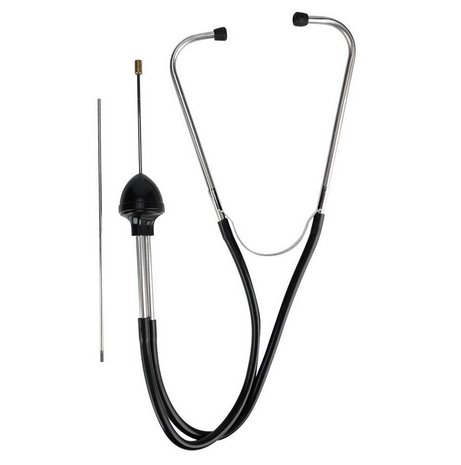

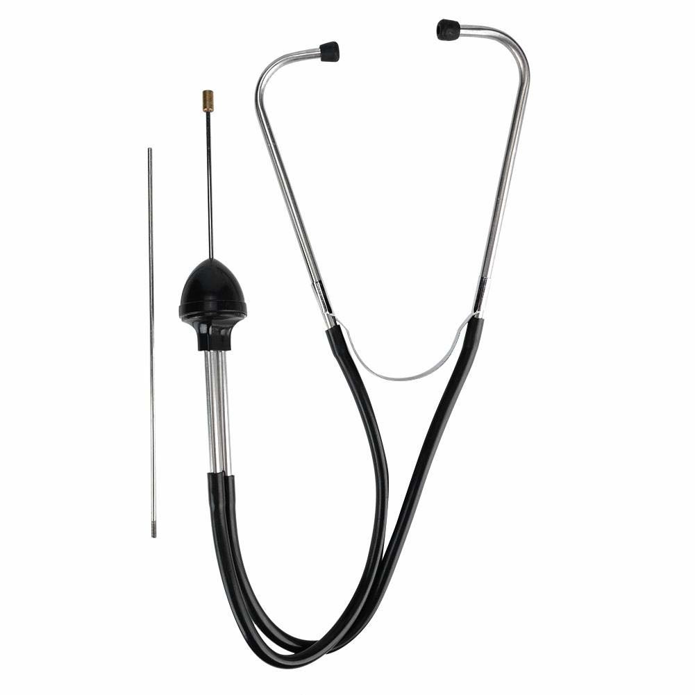

    I'm not surprised - there is a sensor or a nanny or a governor or some electrical doo-dad every where under the hood.
    When is the last time you saw a mechanics stethoscope in an shop? The computers return excellent data these days.
    Hell there used to be a special tool just for a 1953-1957 MG TD with twin side draft carburetors, so once you go them both tuned, you could synch them together mechanically.
    Imagine one tool for one model of an obscure British company's cars for one particular engine. And someone had to know how to use that tool. Those days are gone.

    I still have a stethoscope in my toolbox and a async tool that I used to sync the dual Delortos on an old BAJA I had years ago.
