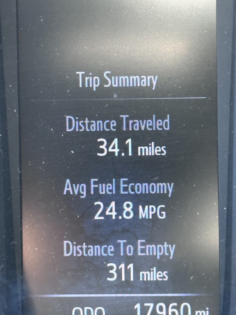

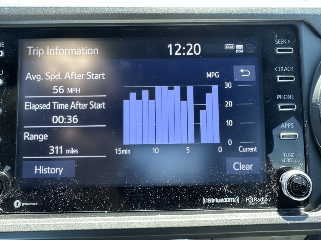

    Just posting up an update.
    No outstandingly favorable conditions or anything. About 1/3 surface streets and 2/3 interstate through Phoenix. Mostly level with very little elevation drop.
    Now not every tank is a 24/25 MPG tank. And I've been running the AC more and letting the truck idle with the wife in the cab so it's averaging out to closer to 21 MPG.
    My distance to Empty is running around 380mi at fill up. This is a far cry better than the 13 / 15 (occasionally 17 if I was really lucky) MPG I was getting before.
    Thinking about running a few premium tanks to see if it's that much better.
