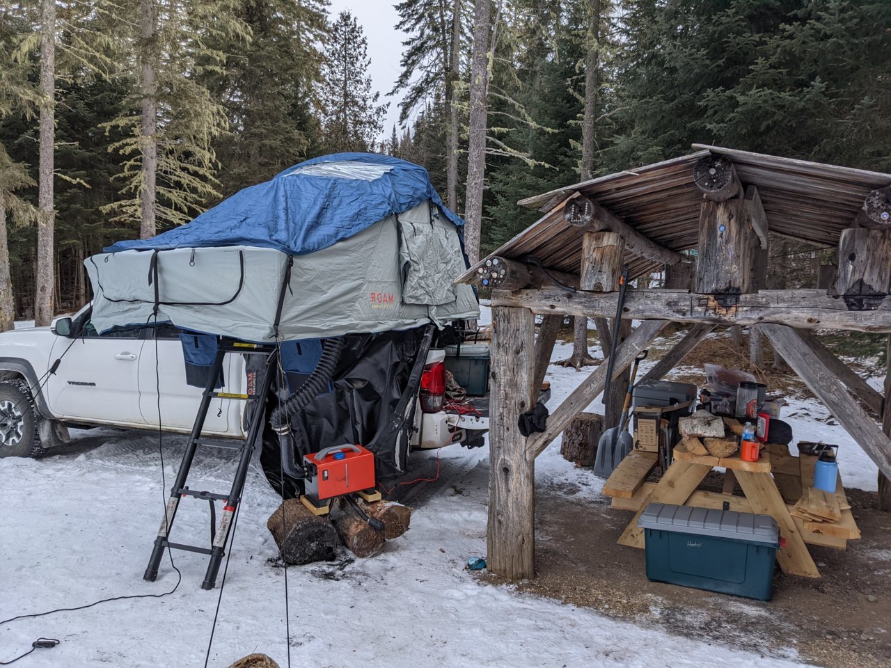

  6. Nov 4, 2022 at 6:03 AM
    Brownie_Man
    Brownie_Man Well-Known Member
    Sep 21, 2019
    #305897
    878
    Maine
    2019 Off Road
    It got down to about -2F and the thing ran all night. Glad I had it.

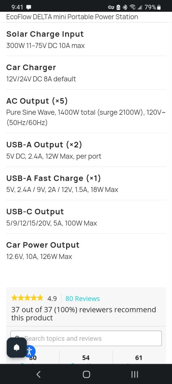

  8. Nov 4, 2022 at 6:45 AM
    Mark77
    Mark77 [OP] Well-Known Member
    Nov 29, 2020
    #348171
    2,613
    Mark
    2021 White TRD Off-road
    Nothing yet

  10. Nov 4, 2022 at 10:37 AM

    2019 Off Road
    I use the car type outlet. According to the Golab specs, it is the same as your unit: cigarette lighter output (12V/10A). The heater didn't come with that type of plug. I went to my local NAPA store and bought one and connected it to the wiring of the heater. I can't remember the initial power draw of my heater.
    I have had the power source fault out when first starting the heater. But it always works the second time after I reboot the power supply.
