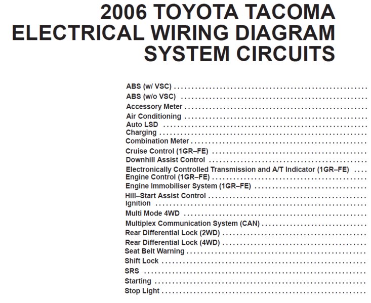

    this is just some of the electrical concerns to deal with that swap & ECU. Just my $.02:smack:
