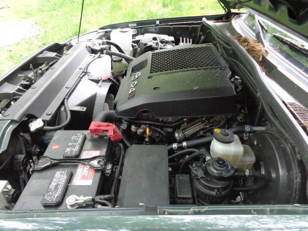

    Diesel photos

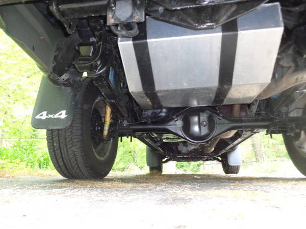

    Second fuel tank 16 gallons
