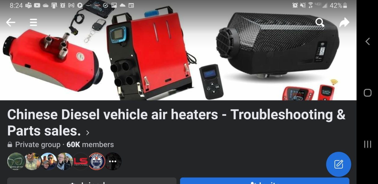

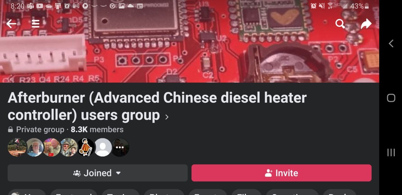

    Here's the Facebook Group that you can learn more. Jones is the owner.
    This is the Facebook Group I follow about Chinese Diesel Air Heater. Lots of good information to learn from.

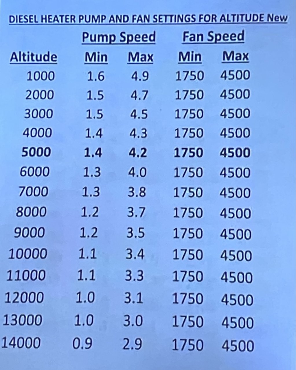

    Not sure about that specific model. But after B_Quad mentioned the issue, I did a bit more research. Seems like the heaters with the "blue controllers" have a setting for high altitude that adjusts the air/fuel mixture to compensate for the lower oxygen. Other cheap models don't have this feature, which results in problems at high elevation.

    I have this too. I haven’t messed with any of my settings but keep it around 2.0 when at altitude and don’t go lower.

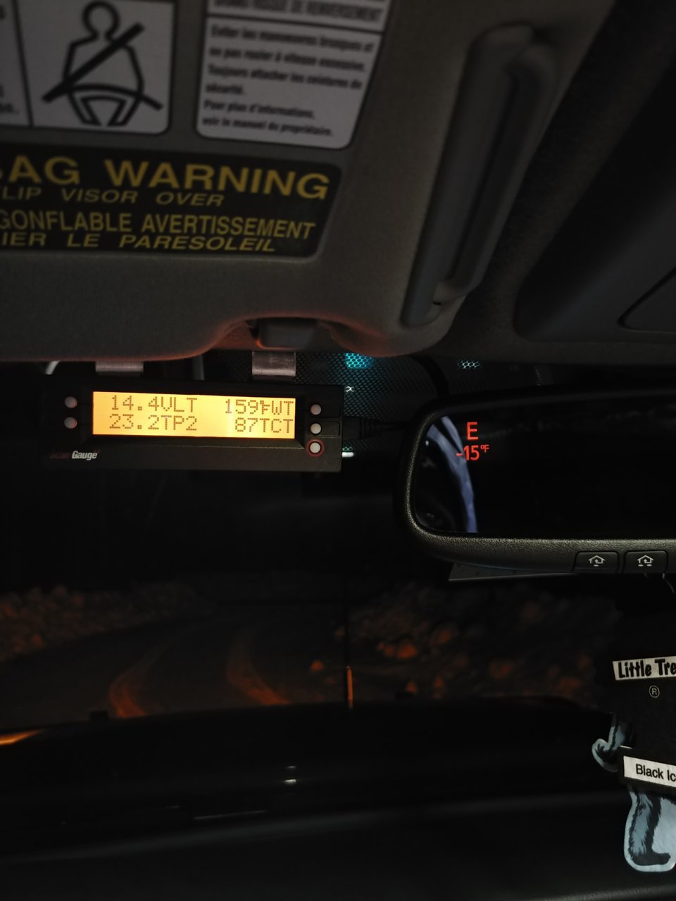

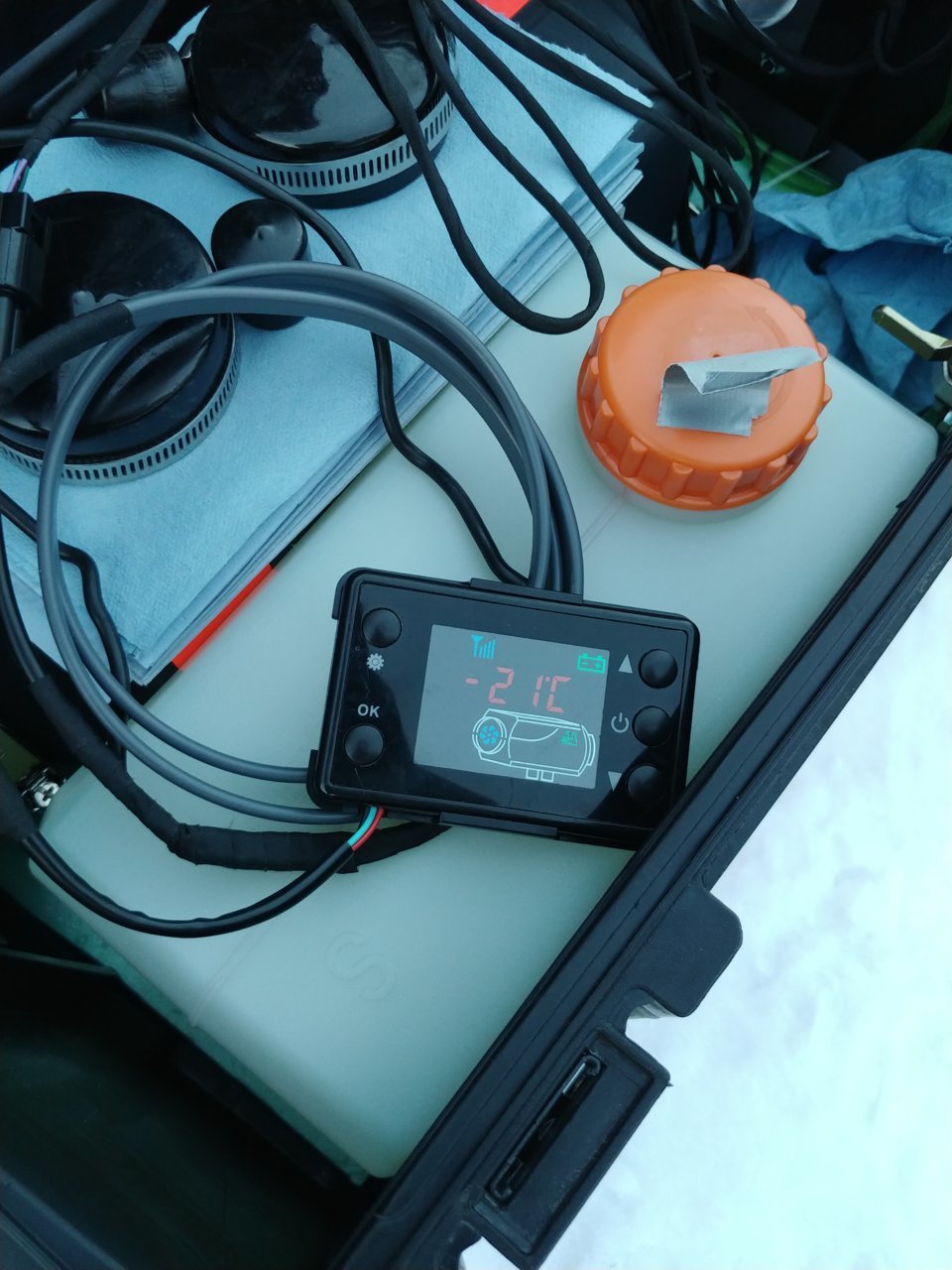

    Coldest trip to date this past weekend. Mixed K1 into the tank earlier in the week about 60/40 diesel to K1. Ran a few prime cycles to circulate the mixed fuel into the lines, switched the valves back over to the heater and lit it off at -21°C / -6°F. Could definitely see the fuel was running pretty thick in the lines, but it did start. Took a bit longer than normal to come up to temp but once it did I hooked the vent hose up, got the RTT deployed and let it warm up. Kept the run of hose from heater to RTT as short as possible!
    Kept an eye on it over the next few hours while fiddling with other stuff around camp - no issues. I think having the tank directly against the heater and enclosed in the box helps preheat the fuel. Coldest I saw that night was -15°F. Tent was a decent 45-60 inside depending on how hard I ran the heater. Kept it set around 3.6-4Hz all night (5Hz being the highest setting on my unit).
