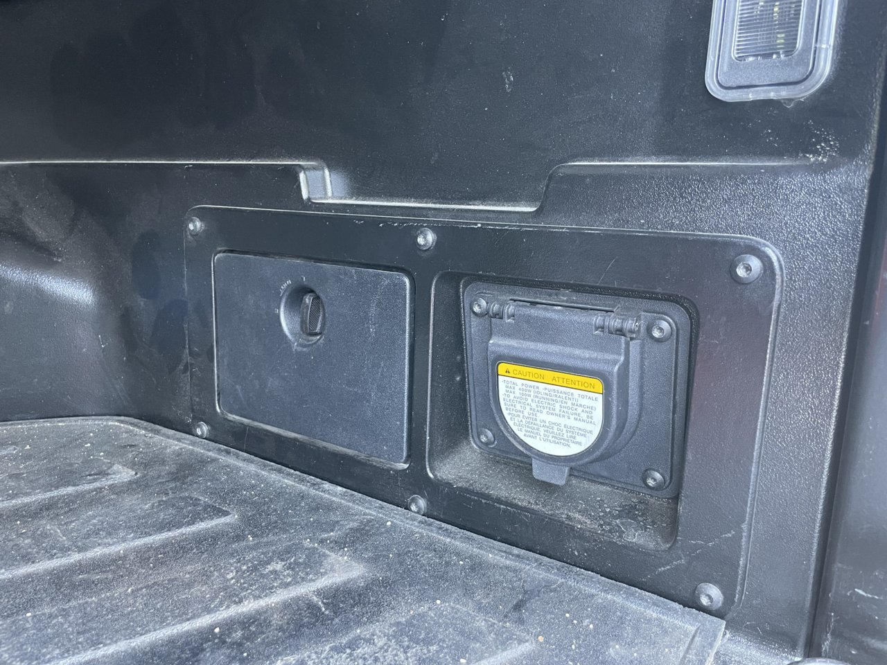

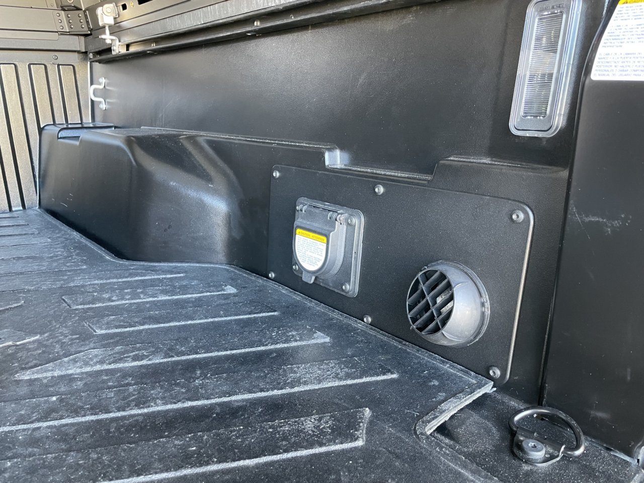

    These diesel heaters are really amazing and safe if installed correctly. I've used mine in single digit weather this last winter and it kept my camper at 60degrees through the night! That was on a low setting. Mine is tucked in the lost space between the bed of the truck and the fender. Full disclosure, I just opened an online shop to sell these brackets. THe heater has transformed my winter recreation so much I had to run with the idea. I'm hoping it opens doors for others!IMG_2372.jpg

    So the real question is, whats the difference between "type 1" and "type 2" on the heater mounts.

    The difference is simply whether or not you have he factory 110v plug. IMG_3228.jpg IMG_3229.jpg

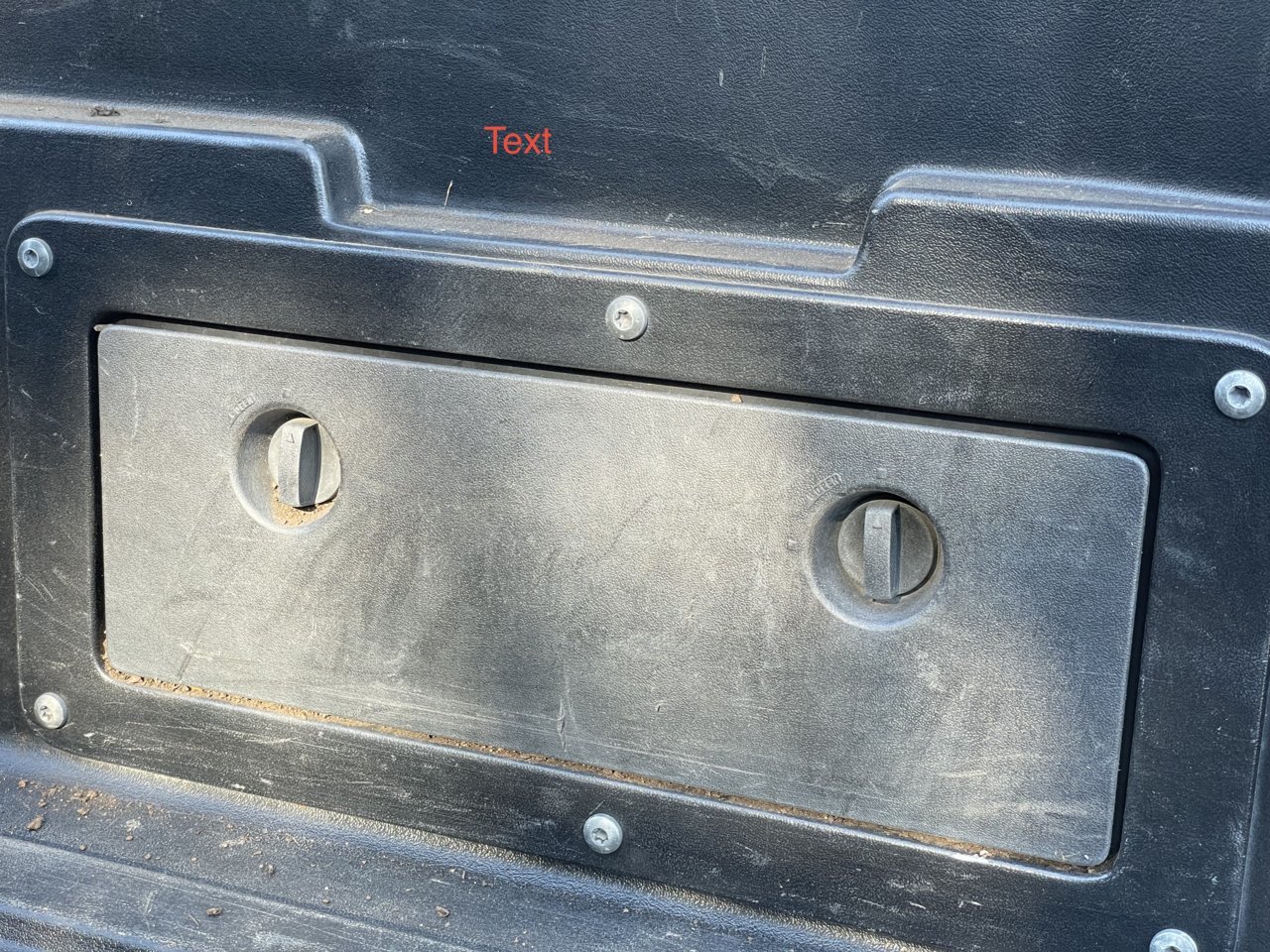

    Gotcha. Can it be fit to either side of the truck? I use my outlet and little storage box, but my big storage box on the driver side is not used at all

    Either side will work! The opening dimensions and bolt pattern is the same.

    Great looking design, I like the use of wasted space. But where does the diesel fuel tank for the heater mount?

    Really where ever you want. A lot of people mount them outside because diesel fuel smells horrible. I mounted mine inside on the drivers side for easy filling. I also like to keep everything low profile.
