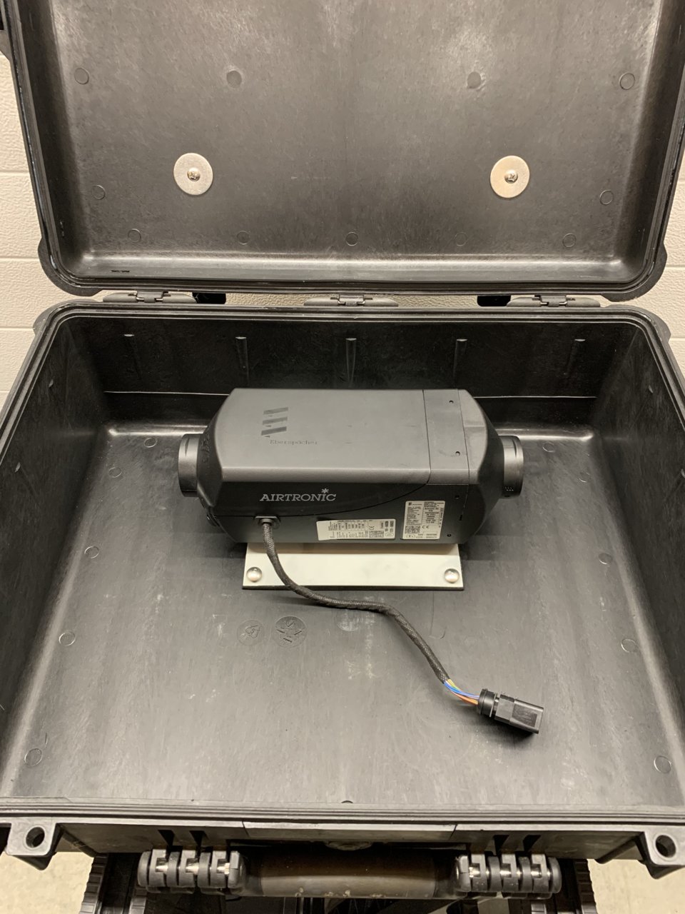

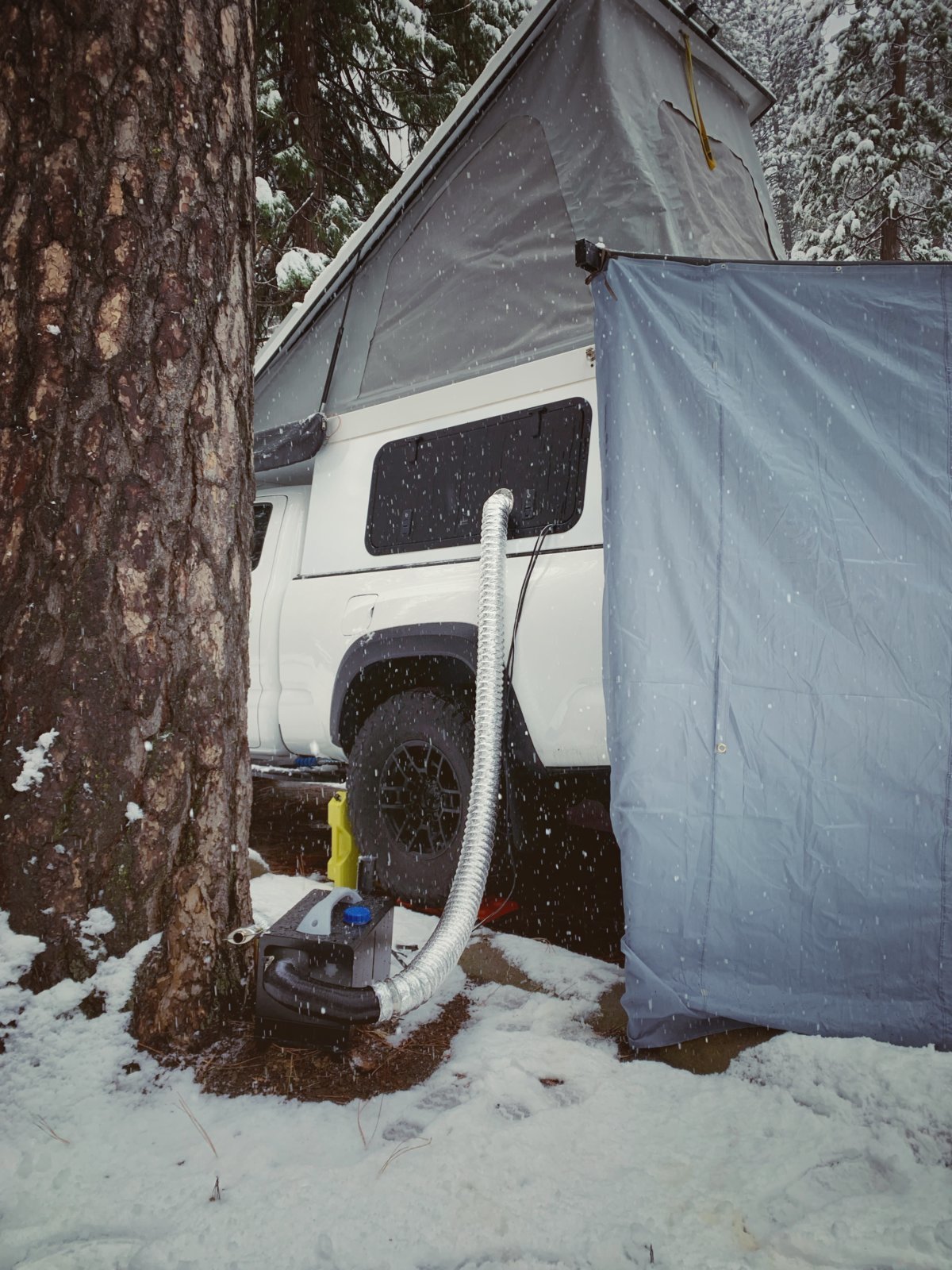

    Ran this heater 31 hours straight without a problem.

    You should insulate your hose it would heat up much more efficiently.
    I have an insulation blanket that wraps around and fastens with snaps.

    225
    2020 TRD OR LB
    Please post photos and details! Great idea. I use this thing 3 to 4 times a year and it all fits into one box. Didn't want to make it to bulky or complicated. Would love to see you blanket and any links for materials.

    I only needed one. You'll probably need more than one with the length of your hose.
    https://www.heatso.com/thermoduct-insulation-for-75-80-90mm-ducting-hose/
    It would probably be easier & less expensive to buy blanket sew it up and add snaps.
