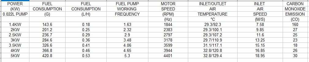

    Do you have the current fuel/rpm tables to keep that thing from sooting up? This is the most current tested table afaik.

    Here’s a chart right off their site. I believe it’s a little less than 2A draw when it’s running. I’ll let you guys with the brains figure out the conversions on this page…
    I also plan on not shutting the truck off until the heater is running. Park, fire up the heater, get set up, by that time the glow plug should be off and I’ll be pulling minimal power.
