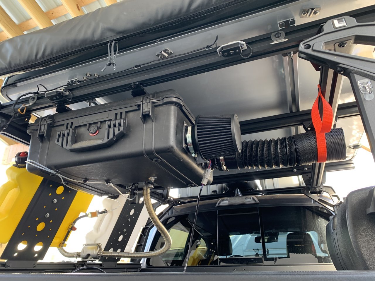

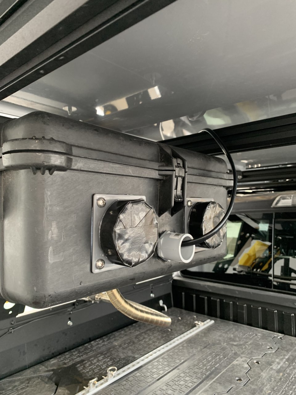

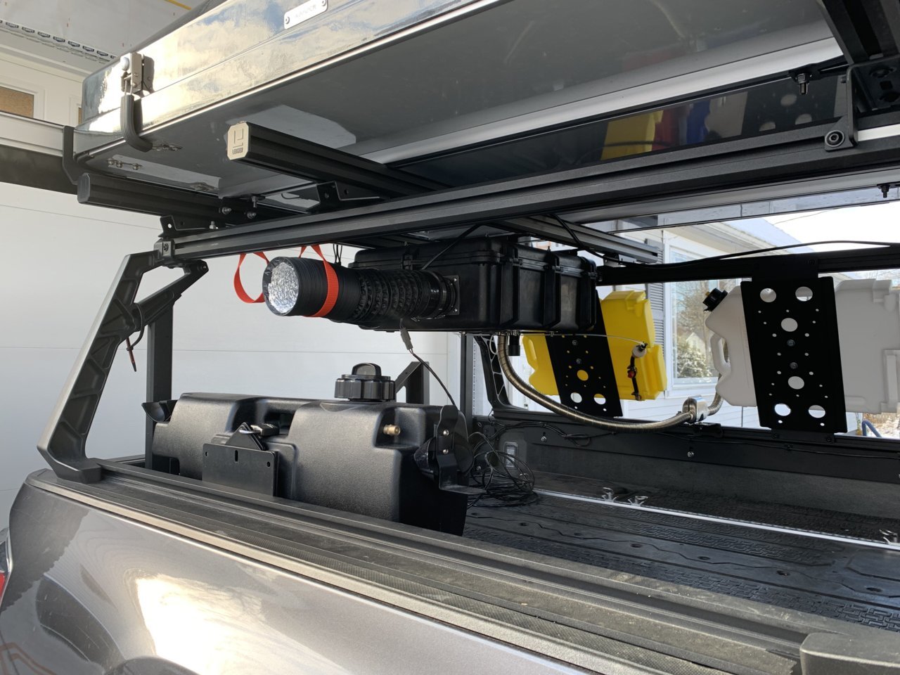

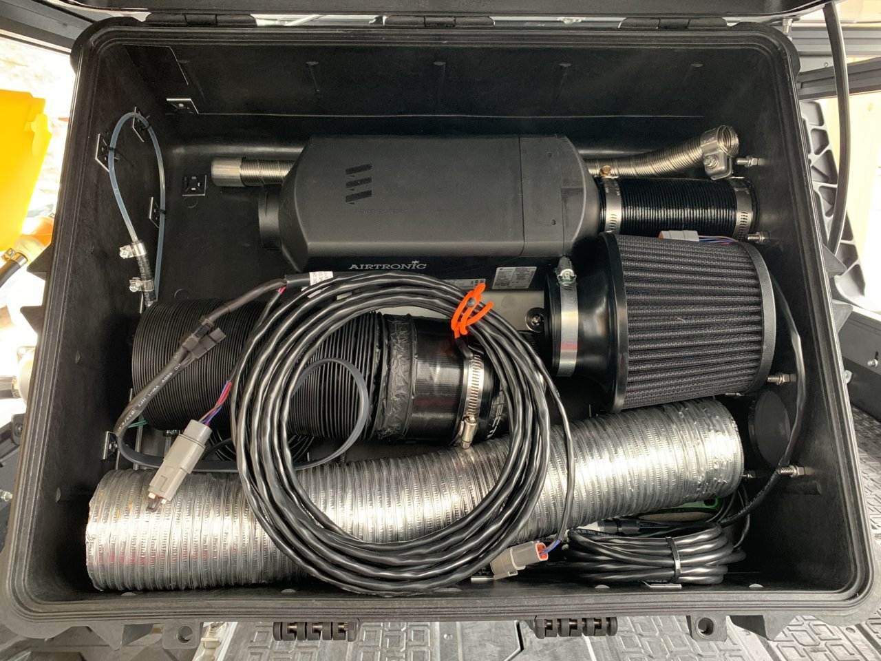

    99% finished, works perfect. Everything packs up nice and neat in the case also. Filter, ducts, tools and controller. Only things left to do are get some hose clamps for the travel caps (custom :D) and wire in the cigarette plug tomorrow so I can run it off the Jackery. The test run yesterday exceeded my expectations. 12 hour run time on the highest setting. Used 1 gallon of fuel and only took the battery voltage from 12.33 to 12.03 (still hard wired until I install the cig plug). At least I know I can run this overnight off the vehicle and have no worries :cool:

    Did not realize you got a name brand Eberspacher. All fancy I see haha
