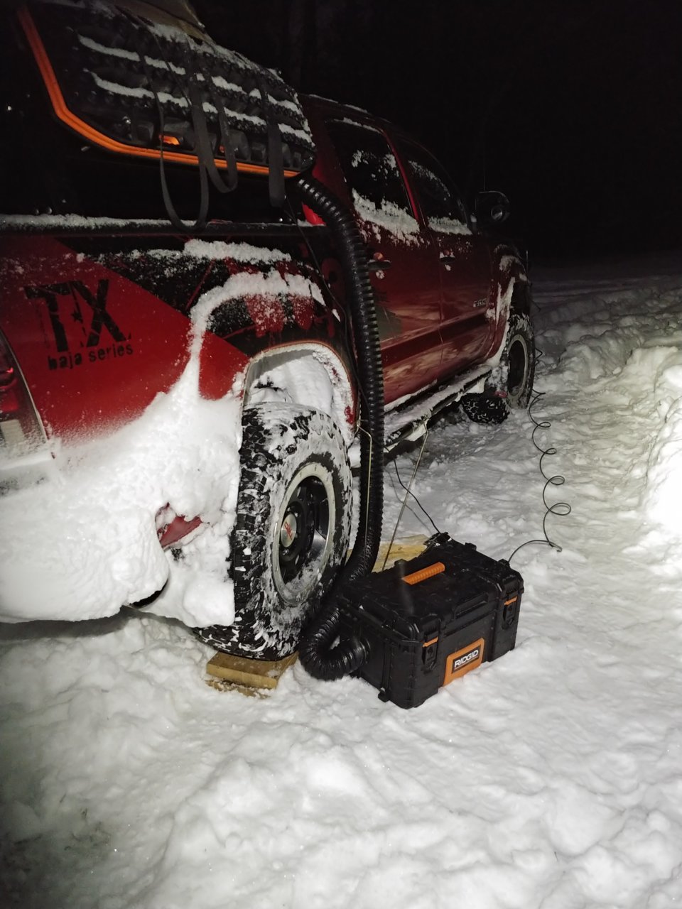

    I was just talking to my friend about this last night. I think I have about $1600 in it total.
    If you went with one of the Chinese versions you could shave 1k off of that easy.
    If you didn’t use a pelican case (I had it laying around not being used but factored that in the build price), probably shave another 100 off.
    Rotopax setup was around $100, Chinese versions come with one.
    I bet you could get in to one for 250-300
    Zack? @SR-71A

    250-300 really isn't a bad price tag to have heat like that for camping. Too bad I don't trust myself to rig something like this together, lol.

    Yeah, I would estimate $300-500 to do a build with a Chinese knock-off. Depending on how you build it and what you build it in.

    I assume you only will have it mounted in winter? If so great idea on Rotopax. My main grip on them is the summer performance as they swell up big time but not a problem with winter

    I don’t disconnect the fuel line when I refill the rotopax tank. I put an inline shut off to make changing the fuel filter a less messy process. When I initially fired it up, I had to go through 4 cycles to get it primed. I wouldn’t want to drain it and re prime it every time I turned it on!

    Yeah it’s only for the winter

    Landed in Laguna beach Christmas Eve, spent a week camping in 18-30 degree nights along the way. This thing absolutely cranks!
    Because I have it powered off my vehicle battery, the first thing I do when we get to a spot is fire up the heater so it goes through the glow plug cycle before I shut the truck off. I put it on infinity run time and 100 degrees so it won’t cycle on and off through the night. Glow plug cycling is what uses the most power, and it heats up the GP every time it shuts down also to help keep the system clean. I also start the truck in the morning before I shut it down.
    100 sounds hot but it’s been perfect. We leave the windows open and it creates a positive pressure in the tent. Only used the annex on the first night because of the rain/ice but it kept everything warm then also. Couldn’t be happier with this setup!

    Luckily I haven't had an issue yet (haven't quite broken the -10*F mark that I know of). That being said kero will be go-to if I do ever have issues. Not to mention Im sure it would be way easier to buy a jug of kero rather than trying to fill a tiny 1.5 gal plastic tank at a diesel pump :rofl:
    I put mine to work the week before Christmas. 2nd shortest day of the year, just over 8.5 hrs of daylight.. Didnt find a campsite until well after dark and the temps were falling fast. It was nice to be able to fire that thing up and keep the tent warm while setting up camp and eating.

    I gotta make it up to the north woods
    That’s been awesome to have everything warm up while we’re getting everything else set up and eating. Not to mention the complete lack of condensation in the morning, I still look up just to make sure my head won’t get soaked!
