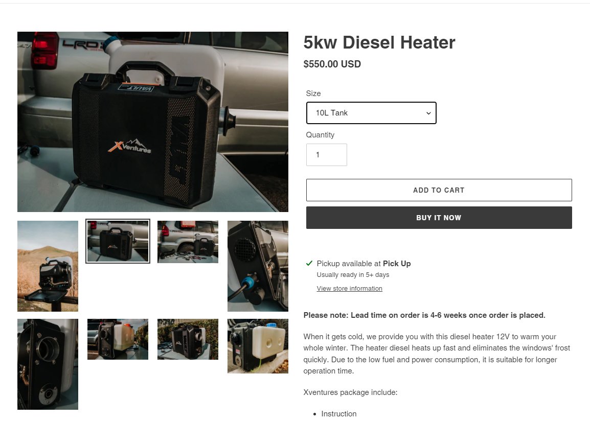

    Only $550 plus tax

    That’s a good deal.

    So I ordered one. From IntoXventures. 10l tank. 4-6 weeks. Now to buy a new tent.
