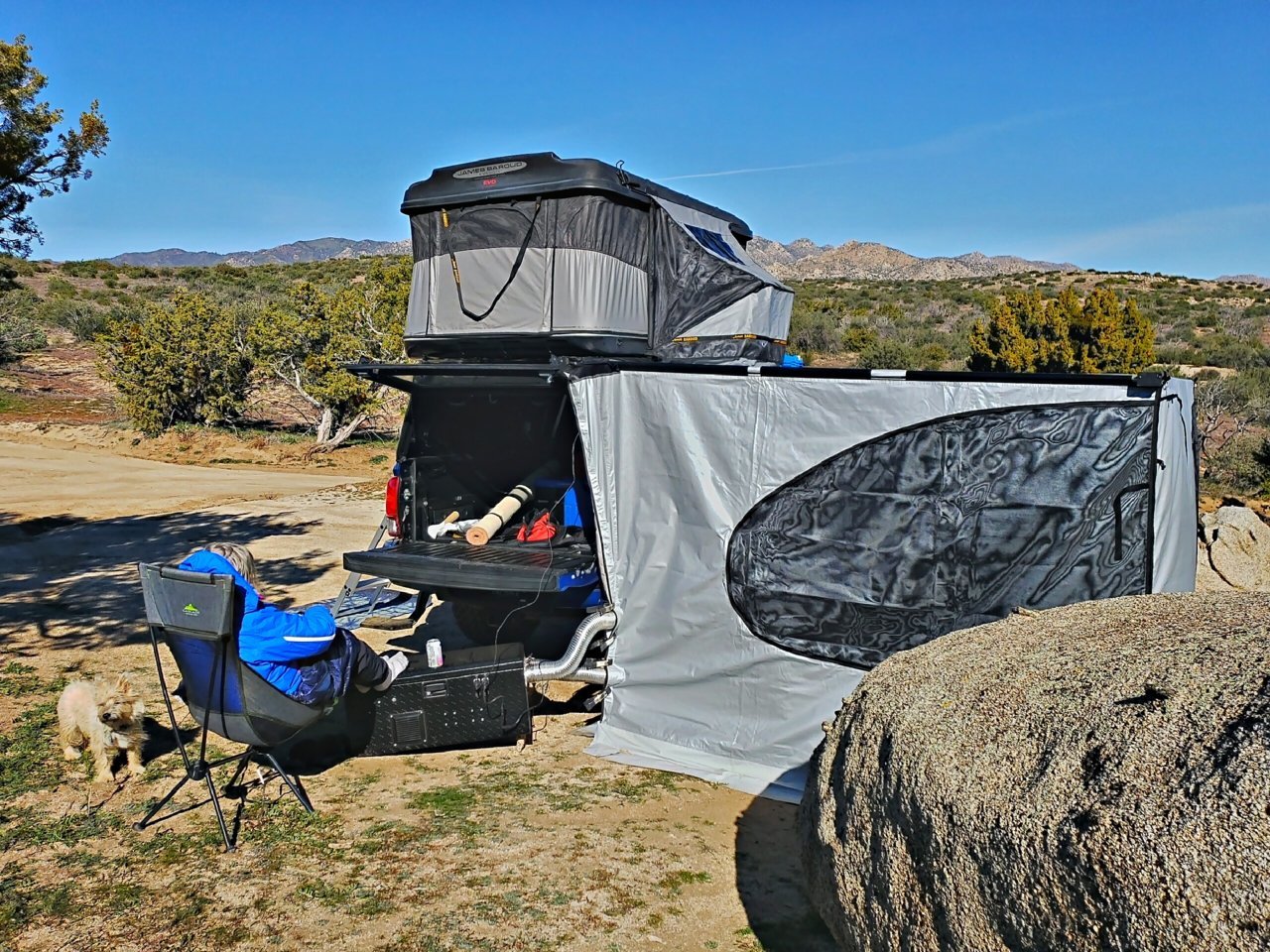

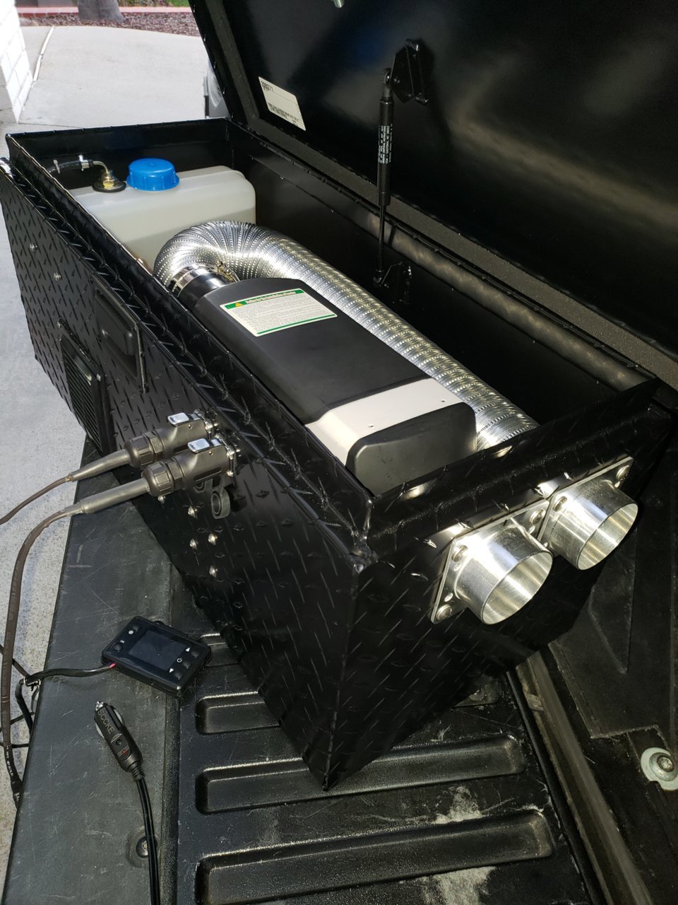

    I built my own last year before a winter trip from Southern California to Wisconsin, camping along the way. I used a large enough aluminum case to strore all the hoses, wiring and other related stuff.
    Used it this past week with my James Baroud Awning Enclosure (comes with only 3 walls, so I had a custom 4th wall made) with a RRT Tunnel. Made the camping trip very comfortable in both areas.

    I bought and replaced mine with a much quieter pump, wrapped it plumbing insulation this year. With my water sealed box, I can barely hear it now.

    Love the electrical passthroughs. Ive had some Amazon ones in my cart for a while for this exact purpose.

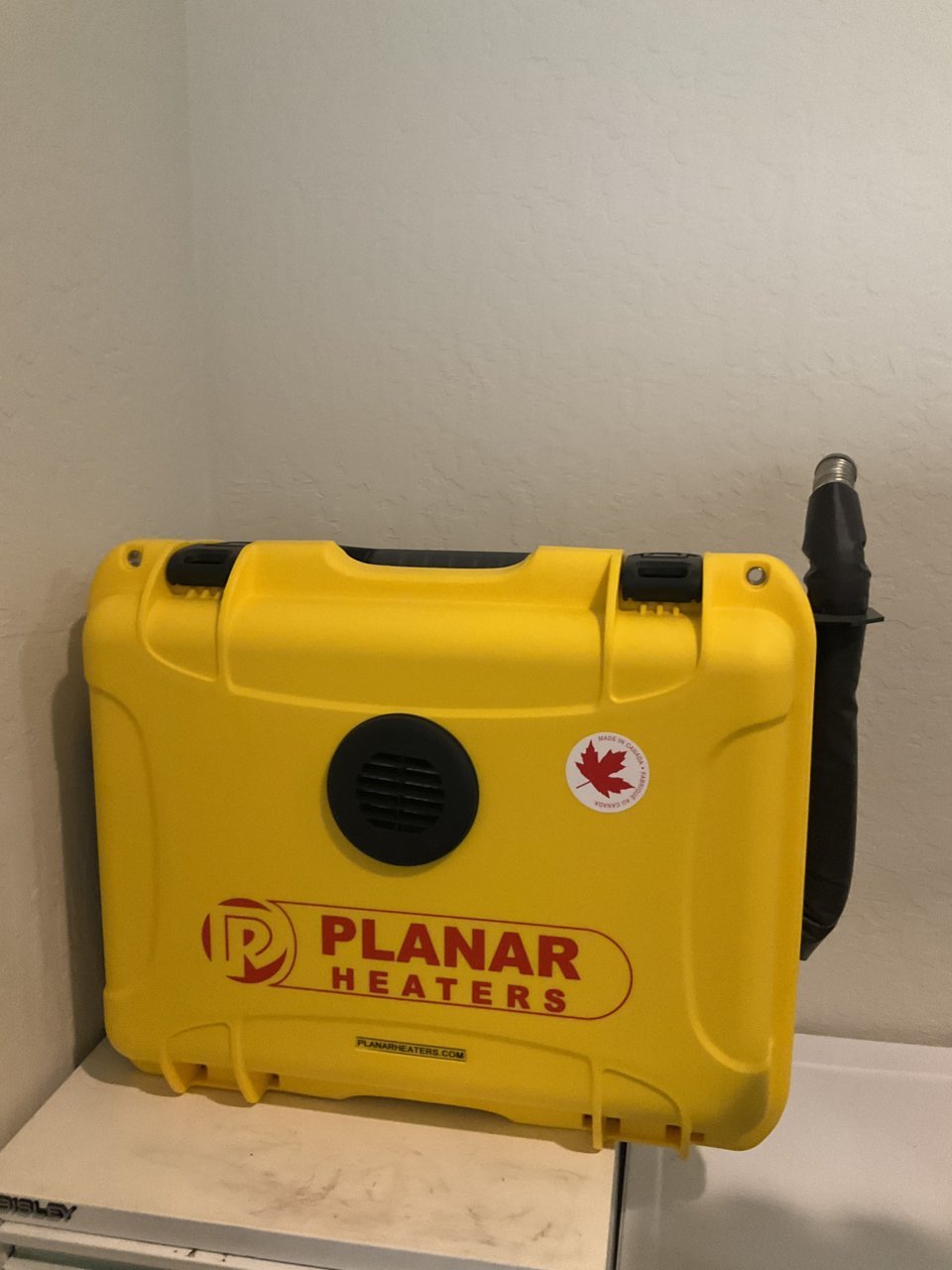

    I purchased online from Target, but it isn't sold there any longer. I attached the information about the Box.
