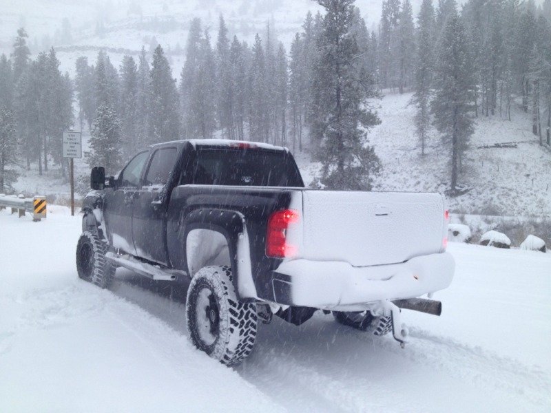

    It's adjustable between 7 and 9" in the front, (Set at 7" for a comfy ride) with 6" lift deaver springs in the rear 'cause lift blocks suck. Selectable lockers are cool until they don't work. This one just works, mash on the gas and it hooks up. No buttons to push or any switches, it just goes. Unlike the Detroit locker I have in my Taco, the G80 is not noticeable at all for daily driving. The detroits are pretty old school, might as well have a full spool really.

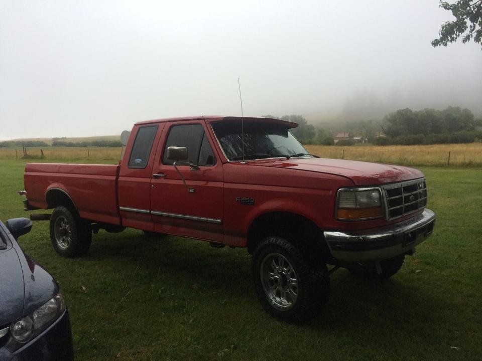

    This is mine, another thing to remember about a diesel is they are a lot more money to maintain than a gas truck. My pickup takes 15 quarts of oil every change, it rings up between 100 and 120 bucks to change the oil depending on the price of oil at the time. I religiously run Rotella 15w40 in mine too, hot or cold, always run 15w40 in a diesel engine. Other than that, they are a great truck and can pull anything you hook to them. Most I've ever pulled with mine was 26,000# and it held 60 on the highway, took awhile to stop though!
