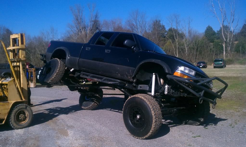

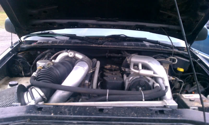

    That'd probably be the "easiest" and "cheapest". Quoted because, well, it's not actually going to be cheap or easy at all.
    A guy here at work has a 4BT in his S10. He probably has 10k into the motor/trans and everything to make it work.
    The good thing about 4BTs is that it's all mechanical... so that's pretty much the only part that makes it easy.
