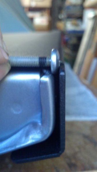

    I was trying to remember why I had to slide it on from the side, too, and I just remembered: at some point, Toyota added two panhead screws at the top corners of the tailgate. These protrude straight up just enough to take up the fraction of an inch that you need to "pop it over the lip" from the top. Mine's a 2015, perhaps they started this in 2012. Perhaps this was their attempt at "strengthening the weak tailgate." LOL. It does nothing. Eric at Relentless acknowledged this too in another thread.
    I know I have a pic somewhere, I'll look for it. I was going batshit crazy over this until I figured it out. You can remove the two screws with no ill effect, especially because the new tailgate plate is being added.

    OK, here:

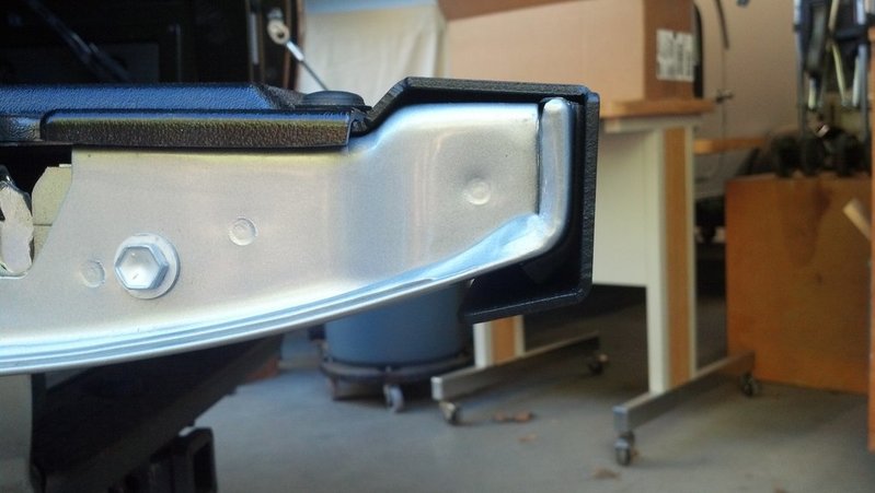

    Clearance pre-screw-in-top-of-tailgate-Toyoya modification in later 2nd gen:
    Clearance (or lack thereof) created by new screws added to later 2nd gens:

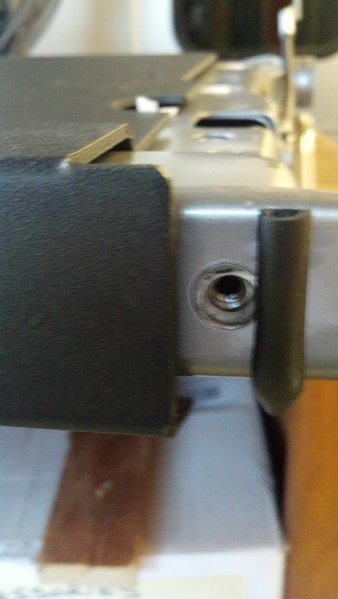

    Another view from top during intstall/during WTF phase. I added soem D-profile EPDM to help keep water from intruding into the hole. If I had time to go find some perfect countersunk screws to insert, I would have, but even they would not have seated down flush in the existing holes.

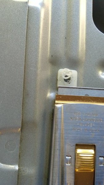

    Another factor I believe for smooth lineup and fit is excessive flashing on the plastic trim nuts used to secure the tailgate screws. I trimmed all mine flush to ease fitment:

    While I had the fiberglass panel off, I checked those screws, and found that they are required for the assembly. (You don't really think Toyota would put them in there for no reason, I hope). I too was going to use flathead screws if needed, but they weren't, as the weatherstrip used as spacers held the reinforcement up just high enough to clear the screws. Together with the weatherstrip on the face of the tailgate, the panel fits nicely in place with no rattles, and the shoulderless screws lock it down. BTW, I did't use the weatherstrip Eric sent, but found similar at OSH, to go the full length of the top, and all but the middle 8" of the face, as there wouldn't have been enough room at that point due to the curve of the gate.
