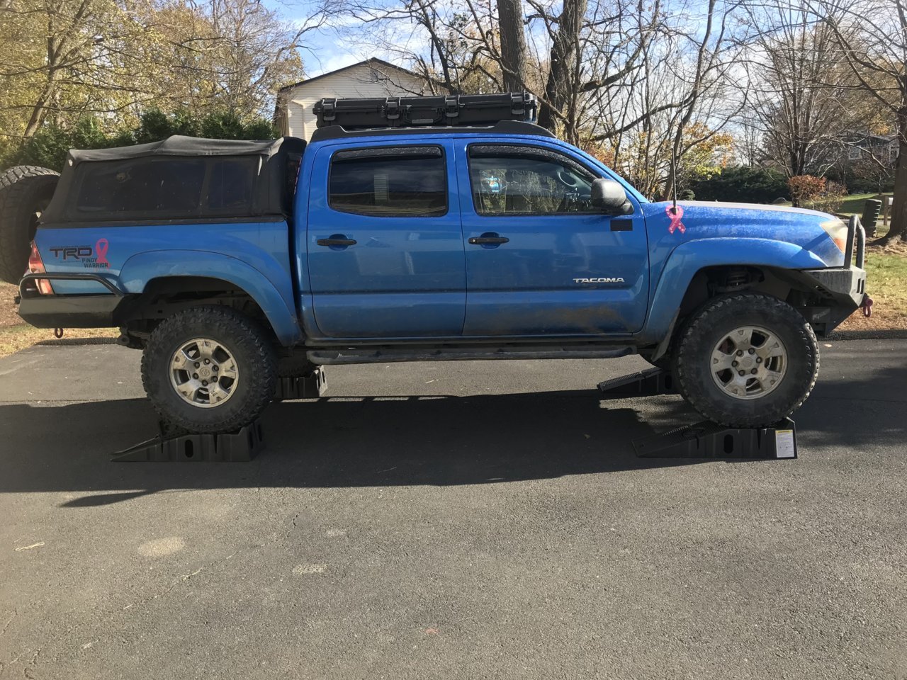

    Three Year Update
    Happy Birthday Diet Taco!
    Well it has been three years since I picked up the Tacoma from the dealer. So far the build has gone well and we've had so many great trips and memories. With the recent addition of the sliders the major mods are pretty much complete. There is a long list of lesser mods to be done over the coming years which for now include:
    • A/C condensation drain extension
    • A/C control modifications
    • ES radiator bushings
    • No slip patches on sliders
    • Temporary slider gap cover for rear passenger door (daughter's door)
    • OBD-II Reader and Display
    • Low profile quick disconnect hardware for FlipPac struts
    • Cabin air intake rodent screen
    • Under throttle body rodent screen
    • Cam tab reinforcement
    • Exhaust trim
    • Bed mounted fire extinguisher
    • In cab AC outlet
    • More in cab USB ports
    • Side shade panels for awning
    • Shade solution of some sort for the rear
    • Rear mesh screen curtains
    • Sound dampen/insulate rear cabin wall behind seats
    • Remount FlipPac without bed caps
    • Additional bright LED brake lights near top of FlipPac
    • Temporary air intake relocate for water crossings
    • Rear camera anytime
    • Front spotting camera
    • Dash camera
    Wow, that's quite a list actually! Some of those are only under consideration and might be rejected going forward. Which brings up the subject of the rest of this birthday post - things I thought I'd need that I've decided now I can do without!
    Things Not Needed
    Fancy Bed Built Out
    Originally I thought I'd probably end up doing a fancy bed built out with things like seats or benches and a table and such. I started with a simple raised floor because it was quick and easy and very flexible. Well that flexibility has proven to be a winning attribute, so much so that I'm going to stick with just the raised floor. Moving/stacking/removing the two action packers allows that space to be used in a variety of ways that a more permanent fancy configuration could not. When I'm just solo with the Flip-Pac open I can just leave them in place. When my family is along I usually put the action packers outside because I'm usually cooking out there and it opens up the raised floor as a place for my daughter to sleep. If I'm solo in foul weather I can leave the Flip-Pac closed and put the APs outside so I have a comfy little cabin to hole up in sleeping diagonally. If I need to "stealth" camp/sleep I can actually stack the two APs and still sleep diagonally in the back. It can even make a comfy shaded lunch spot when solo or when just my daughter is along if I point the tailgate away from the sun.
    The under floor storage has worked out great as well. There is essentially no packing/unpacking required to set up a FlipPac based camp in a hurry. Fuel and water are tucked out of the way until needed. Chairs, table, camo net and other such things can be pulled out only when needed and aren't "in the way" the rest of the time.
    Fancy FlipPac Lighting
    I had thought up some pretty cunning lighting solutions for the FlipPac beyond the two rather bare-bones lights. I did upgrade those fixtures to support red/white lighting but beyond that I now think I'm done. I have found they provide plenty of light for doing the usual bedtime routines with my daughter. I don't really have any need or desire to throw lots of light up into the upper mattress area. Most of the time I actually leave them on red simply because it means I don't have to worry about bugs when the back is open. Supplementing those lights with a headlamp is about all that is really necessary. In general I prefer a pretty dark camp.
    Fancy Exterior Lighting
    I also had intricate plans for exterior "camp" lighting but the reality is with our typical "always on the go" exploration style we never camp in the same spot twice and so our camps are extremely minimalist and almost entirely contained within the Flip-Pac and right by the tailgate. So there really hasn't been any need for exterior lighting. Again a headlamp or two seems to provide all we need and again bug-free red lighting often the preference. I'd prefer to soak of the stars or the moon than a blinding camp light.
    Things Not Used Much
    Propane Fire Ring
    Our portable propane fire ring has seen approximately zero use other than taking it out for entertainment twice. When solo I have no need for the fuss and would prefer to look at stars. When my daughter is along there is enough bedtime routine that we don't need the distraction of a fire.
    Lynx Levelers
    These are probably just the thing for leveling on pavement. They actually do work great for leveling out in the wilderness too but the thing is so do random rocks laying around. I very rarely have to level at all to be honest. These will probably be removed from the truck soon to make space for recovery gear that could potentially also serve as a leveler when needed.
    Annoyances
    Power Coat Dust
    My biggest annoyance at the moment is that the top of the tailgate cover gets abraded by the FlipPac door. No big deal since the cover is aluminum and can't corrode even as some of the powder coat gets removed. The annoyance is that the dust from the powdercoat brushes off onto my clothes and is nearly impossible to get out. So I need to remember to wipe down the top of the tailgate after every trail run or I end up with black dust on me. This is one of those minor things that just starts to piss you off the fifth time you ruin a shirt by leaning against it without wiping it down first. Will need to think of some sort of solution to prevent this, likely a sacrificial layer of something that doesn't make such a mess as it abrades.
    Things to come...
    I'm still waffling on what my "final" recovery gear set is. Being I've never really had to recover myself in about twenty years of off-road travel probably makes me complacent. Time to think it all through a bit more. Fundamentally though my worst case plan is always just to camp where I get stuck while I wait for my satellite message requesting vehicle assistance to be responded to - potentially at a high cost!
    Not mentioned before I think is that I actually have had two Sway-a-way replacement torsion bars for the Flip-Pac in my garage. As soon as they started making them I bought two as it is the weakest point in my build and for awhile there was just no source at all. I kind of live in fear of that torsion bar and the FRP one is of course unknown junk. I'm thinking that I may replace the FRP one with one of my Sway-a-way ones rather than waiting for another unfortunate breaking event. Logistically doing the swap sounds like quite a hassle so I haven't worked out exactly how to do that as it needs probably two or three people plus a way to hold the lid in the vertical position while the swap is done.
    And of course that big long list at the top of this post...
    I've also taken the time that past few days to go back through all the older posts and put three year updates in where appropriate. They are all marked with 3YR UPDATE so you can search the thread easily if you care.
    It has been an amazing three years, not the least of which is meeting so many great folks from here on TW both virtually and in person. I budgeted about a twenty year life for this vehicle so here's looking at hopefully 17 more great years going forward!
