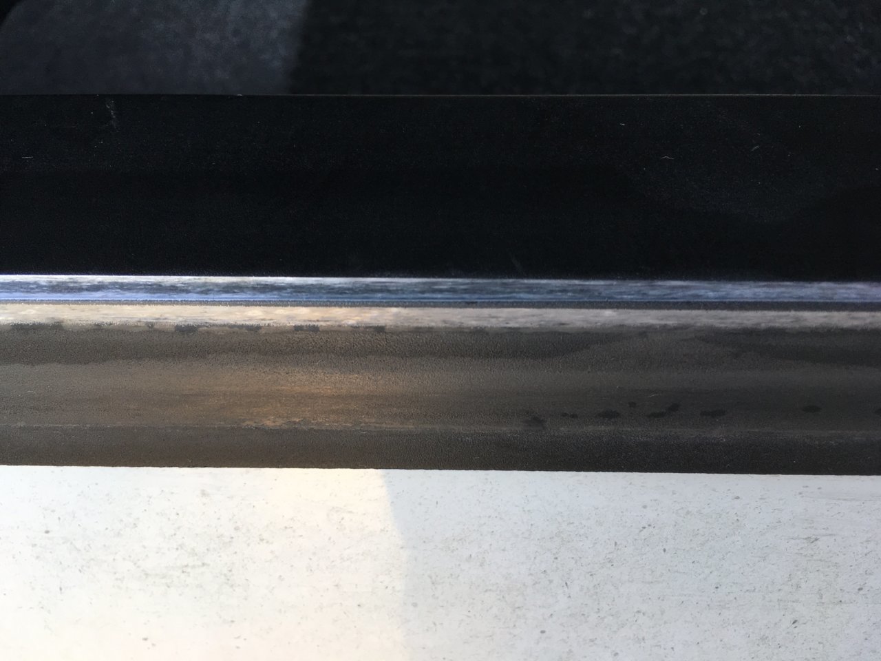

    Tailgate Abrasion Mitigation
    October 2018

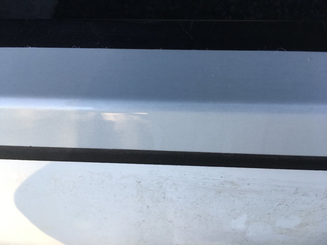

    This is a real simple mod and perhaps not the final iteration but hopefully good for awhile. I've got a aluminum tailgate cover and it is powder coated. The bottom gasket of the Flip-Pac rear door naturally overlaps with it. With trail dust that gasket acts like fine grained sandpaper and abrades the powder coat. These days the top of the tailgate looks like this:
    Now since the tailgate cover is aluminum there isn't any sort of rust issue. The real problem is that the powder coat dust is extremely messy. If I forget to wipe the top of the tailgate down and lean over it I've got a nearly impossible to remove black streak across my shirt. Worse still the rear door rubber gasket now acts practically like an ink pad since it has been impregnated with this extremely fine black powder coat dust. Drive down a dirt road for ten miles and run a paper towel across the top of the tailgate and it comes back jet black. I wiped down the door gasket a good ten times with a wet paper towel before it finally started only making the towel gray as opposed to black.
    The door and the tailgate are always going to move somewhat independently of course - everything flexes and jiggles off road. There will always be dust as well. I had hoped the problem would abate as I got down to bare aluminum but well it hasn't seemed to. So I'm now trying a simple solution - an ablative layer of tape.
    A local HD had some inexpensive white reflective tape. It is very smooth which perhaps will reduce the amount of abrasion slightly. More importantly though any dust generated won't be black. A side benefit is that when I have the tailgate down in a parking lot at night it will be much easier for other vehicles to see it.
    Cost only about $6. Time spent applying the tape about 5 minutes. Time spent cleaning all that dang powder coat dust off the top of the tailgate and the gasket probably 15 minutes. Effectiveness to be determined!

    Tape just might do the trick. So simple and versatile. :) So much hate for the black dust problem you described. :rofl: :D. It kills your clothing :oops: :bananadead: image of you breath it in. :eek: :p:)

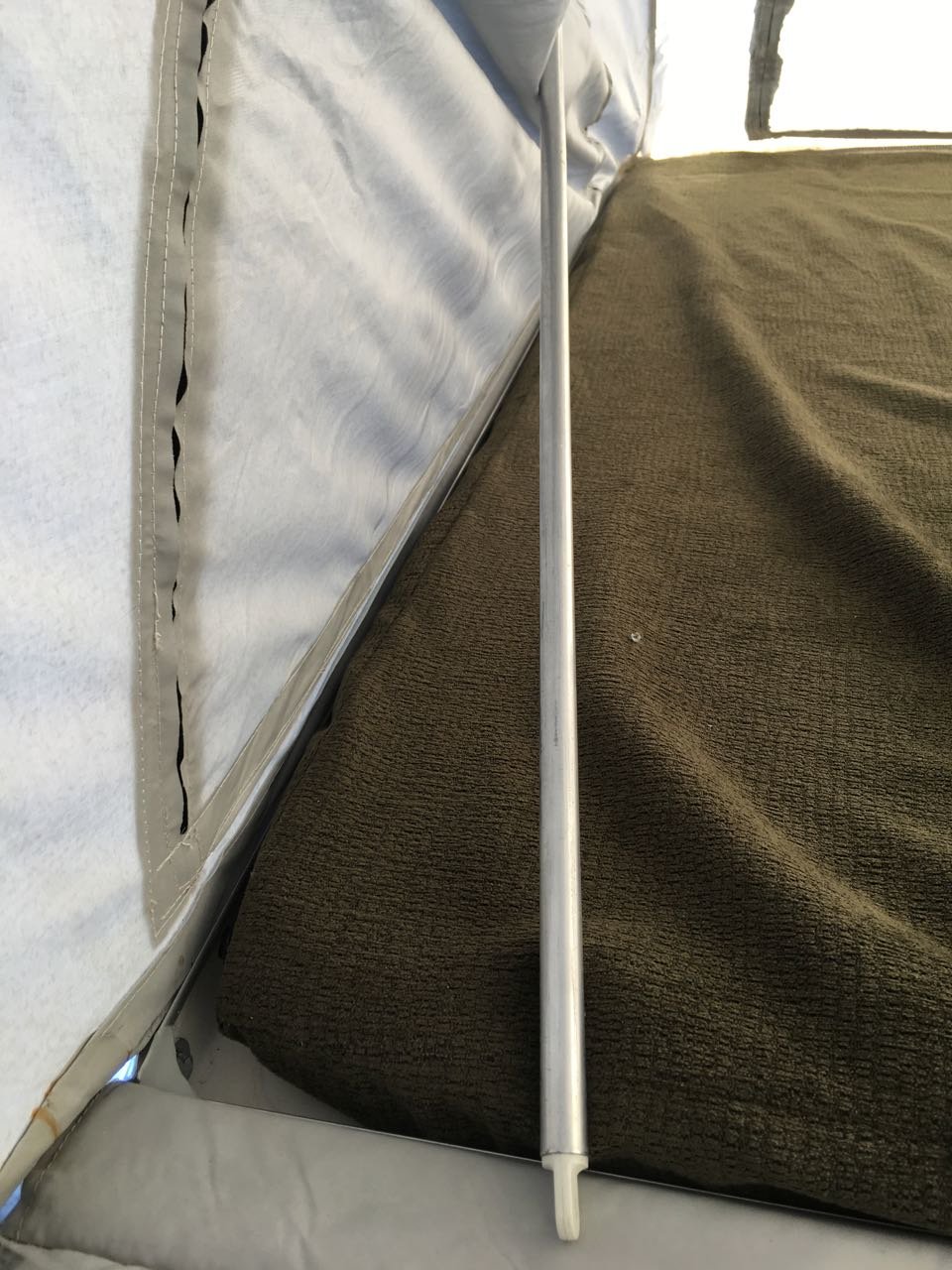

    Well one of the Bimini brackets that supports the tent frame had somehow pulled out of the fiberglass. The bracket being plastic it was also bent. This wouldn't be a major repair, in fact I might even be able to do it in the field. That said with the wind forecast for the next day I decided it might just be better to head back to Vegas in the morning and do the repair there with a Home Depot nearby and internet access for repair advice.

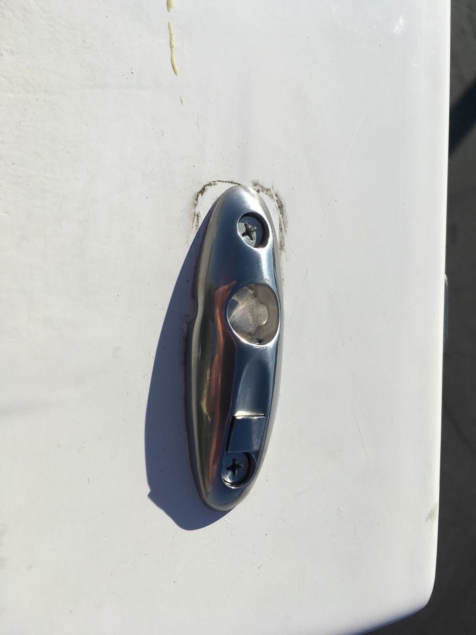

    As mentioned in the MNP trip report the Bimini bracket for part of the tent pulled out of the fiberglass.
    Now it just so happened for quite some time I've been meaning to replace the Bimini brackets on the Flip-Pac roof (when closed) / bed bottom (when open) so that I can store the supports in the cab rather than have them get ripped off by low hanging branches (already almost happened once). I've had the hardware for quite sometime. So long in fact that @inv3ctiv3 was able to acquire the same hardware, install it on his Flip-Pac and then sell his Flip-Pac for a GFC all while my brackets have sat in my "to-do" bag in my truck (this "to-do" bag is like a super miniature version of @scocar's shelves).

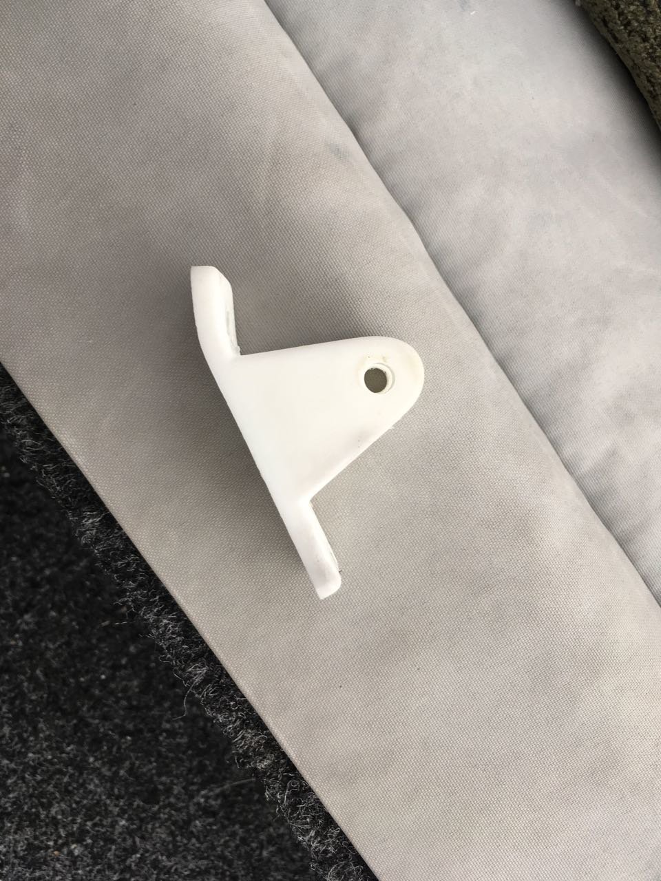

    So with a bent/broken plastic Bimini bracket on the inside of the Flip-Pac to replace it was a good time to remove the identical brackets from the outside of the Flip-Pac and use one as a replacement part while simultaneously completing my removable Flip-Pac support mod.

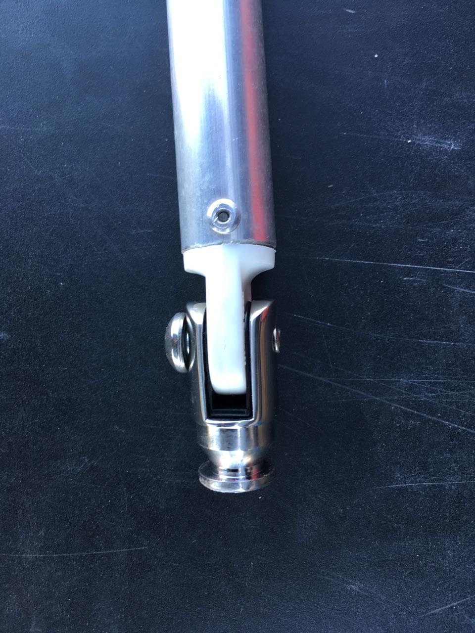

    Swapping the external plastic brackets with stainless quick release versions was very easy. Unscrew the old ones. Reuse one of the screw holes and mark the spot for the new hole. Drill new hole. Fill old hole with silicone. Glob silicone under the new QR bracket and install. Attach QR stubs to the supports.
    And that's all there is to the mod.

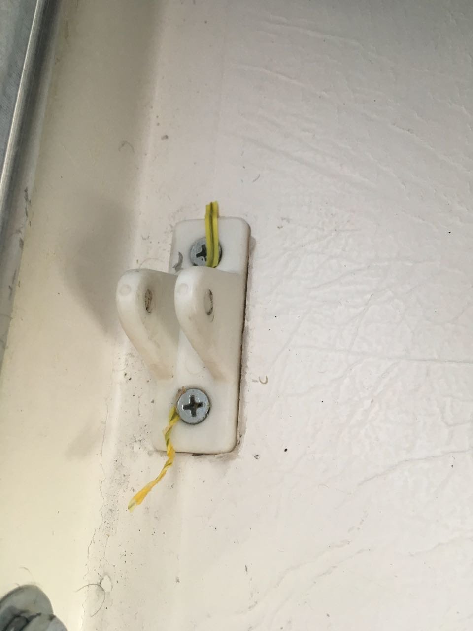

    Now with two replacement plastic brackets in hand I could repair the interior tent support. With some searching I of course found all sorts of suggestions on repairing a stripped screw hole in fiberglass with the right kind of epoxy and then drilling a new hole. This was what I assumed I was going to do and one reason I went back to Vegas early assuming I'd have to track down the correct fill epoxy.
    It turns out while searching for that I found that those ever resourceful and also typically newly poor boat owners have an alternative that is about as low cost as you can possibly imagine:
    Yep, those are the twist ties from my bread and hot dog buns. Apparently the metal in the twist tie ends up acting a bit like a self forming heli-coil and the plastic as thread lock. This was surprisingly secure once screwed in. Time will tell how long this holds but if some boat owners are to be believed it could last a long time. If it doesn't well then I'll track down the epoxy. Or get lazy and fill the old holes with silicone and move the bracket half an inch onto fresh fiberglass.
    I did all this work in a Home Depot parking lot but I never actually had to go inside. Turns out this could have entirely been a field repair if I had known of the twist tie trick.

    I wonder if those plastic drywall anchors would act as a more "permanent" fix for the stripped holes in the flippac. They'd essentaily be doing the same thing as the plastic tie wrap you have there now- forming a mechanical bond by shrinking the size of the hole. I question the structural integrity of the epoxy repair on such a small scale because you're relying on the epoxy to hold the torsional load of the screws while also maintaining adhesion to the fiberglass. As opposed to f full scale fiberglass repair over a larger area where you're essentially building new structure. I know with the right epoxy a repair can be plenty strong, but also from my own personal experience of working at Home Depot for many years, they most likely don't sell the "right" epoxy.

    I very quickly established that I’d have to order the correct epoxy and wait for it to be shipped to me which is one of the reasons I did the twist tie trick. I like the drywall anchor idea! I think even with the correct epoxy what I’d do is fill the holes and shift the placement of the bracket slightly.
    GHOST SHIP[QUOTED] and Crom like this.

    Hah, I always carry twist ties in my junk can in my truck, and even have a few in my mountain bike pack, but I’m not sure I’ve ever used them. And I sold my FlipPac several years ago :)

    Actually, HD probably does have the "right" kind of epoxy. A 2-part that will work on/with plastic should work just fine for this application.
    And, you can strengthen the current holes in one of two ways. The easy way is to coat the screw with a release agent (such as wax) then coat the screw with epoxy. Put the screw back in the hole, and let the epoxy cure. The stronger way, albeit slightly more difficult, is to drill out the hole slightly larger, and do the above. The additional epoxy will greatly increase the screw's gripping power.
    Yes, there are better epoxys to use (such as West System) but the home center variety would work in a pinch.
    And, I do not think drywall anchors will work properly in fiberglass. For those anchors to work properly, they expand. I think the expansion would work to fracture the fiberglass (the load being into the edge of the glass layers, as opposed to across them.) Also, the smooth hole would offer a minimal to none gripping surface to the anchor.
    My $0.02
