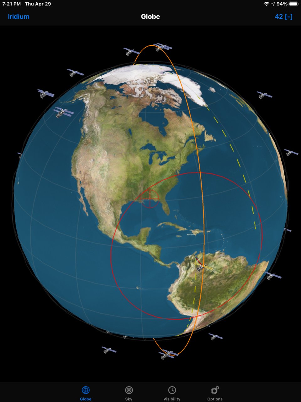

    @DVexile Ken, I always enjoy your well thought out and informative posts. The few recent ones on InReach and PLB have had some very good information. I just wanted to let you and the others who may be interested know about an app that can help greatly with the InReach. The app is called “Orbit,” it’s in the Apple App Store, I don’t know if there is a Google version. The app is actually intended for astronomy to help identify satellites as they pass overhead.
    You are able to select different satellites to be the only ones displayed, the Iridium array being one of them. From there you see the orbits of the satellites in relation to your position on the globe. The satellites will also be advancing around the globe in real time on the display. You can tap a specific satellite and see it’s orbit, the actual ground path it follows, and the area of the globe that it’s antenna is covering. This is very helpful to determine if your signal is going to get out immediately or if you are in a current dead spot due to no satellite coverage. If you are in a dead spot you can select different satellites to help determine when an antenna will cover your area. I realize in a critical emergency you don’t have time to analyze this, that’s when you just need to hit the SOS button and let the system do it’s thing. This is just one more tool to help understand and visualize why the messages may be delayed or when you have the best chance of sending the nightly “I’m OK” call to your significant other.
    FWIW, I’m retired Coast Guard and will soon be retiring from my Sheriff's Office. I’ve done SAR work and been a SAR Coordinator with both. I encourage you to get a PLB or an InReach and carry it with you all the time when you are out and about. For me, the extra messaging abilities of the InReach make it a better choice for the way I travel.
    Screenshot of the app showing my location, selected satellite, and the actual ground coverage of its antennaupload_2021-4-29_19-54-48.jpg

    @Cwopinger thanks for the excellent post! Yes the various satellite apps can be great at figuring out how things are going to work out in the sky. And actually really great at showing just how more robust Iridium is likely to be when trapped in a canyon (see further down in this post).
    A word of warning though for Iridium. Many satellite apps mainly included Iridium for flare predictions which only the first generation satellites produced. As a result many apps do not actually show the current second generation satellites which are the operational constellation. Most of the first generation constellation has been de-orbited at this point except for twenty-something that were failed to the point Iridium could no longer control them which remain in orbit (some tumbling actually) and will not decay for many decades or centuries.
    First generation satellites are numbered below 100 and second generation above 100. So if your app shows you a satellite numbered below 100 then that is not an operational satellite (e.g. in the previous post Iridium 42 is selected which is an inoperative first generation satellite). You'll only want to pay attention to satellites numbered above 100 and even then be aware there are inactive on-orbit spares in each orbital plane. In an app you can usually distinguish the on-orbit spares as they will be at an odd spacing from the other 11 in the orbital plane.
    Again the catch is some apps will only show you the remaining first gen satellites since the apps focused on flares. Make sure your app is showing you the second gen (also called Iridium NEXT) satellites numbered above 100.
    As for app selection there are a bunch that want you to subscribe rather than just buy once. Orbitrack from Southern Stars is a "purchase once" non-subscription app I'm using that appears to be getting regular updates still. I did some screen recordings to illustrate Iridium vs SARSAT as far as sky view diversity goes.
    First up is the Iridium constellation. Note the time marks at the bottom, initially it is playing relatively slowly. I've selected one satellite in an orbital plane so the app will continuously show its orbital path as a line across the sky and that line essentially shows the path for all the satellites in that plane. You can see the actual individual satellites labeled moving along that plane. I started with the plane close to crossing zenith and note how the frequency of satellite passes means that even a small patch of sky will eventually get visited by a satellite. You can see the leading and trailing orbital planes on the east and west horizons (though there isn't a line there you can see the individual satellites). You can a see a few of the first gen inoperative satellites fly through as well. The orbital planes pass zenith every two hours so again if trapped with very little sky view it is very likely within a two hour period you'll have visibility on a satellite.
    I accelerate time at the end of the video so you can see multiple planes pass over.
    Next up is the SARSAT constellation. SARSAT is again just a payload on other satellites so they aren't labeled as "SARSAT" or "LEOSAR" or such. Instead this app has a group you can select for satellites that host a SAR payload. In this recording you can see the GEOSAR satellites that appear to not move at all, these are geostationary satellites and as you will see these are typically the only satellites you expect to see you immediately when you activate a PLB. I've selected one of the GEOSAR and its line roughly represents the "geo-belt" where all geosynchronous satellites live. LEOSAR are the satellites at orbital altitudes similar to Iridium and there are just six of them so we will see them much less often than Iridium. In fact I didn't get a pass at all until I sped up the time at which point you can see they do come by often enough but many patches of sky don't see them for very long periods.
    Now MEOSAR is going to be coming online which are payloads hosted on geonavigation satellites like GPS and Galileo. This will give a much more frequent revisit rate to regions of the sky but presently is not considered operational and has a lower link budget than Iridium if we were in a "no sky" situation and depending on reflection off of canyon walls to get a signal out. As far as I can tell MEOSAR is actually being used and has been for some years despite not being declared "operational".
    Again, thanks @Cwopinger for bringing up a really useful topic!

    Ken, once again wow!:eek: Your depth of knowledge is incredible and very informative. Considering where you live and this knowledge of satellites, do you work for a 3 letter government agency in the Ft. Meade, MY area? Lol.
    I knew there were new Iridium satellites in orbit but didn’t realize so many old ones were inoperative or deorbited. I was also aware many of the astronomy apps are designed for the antenna flare visibility but that also meant the antenna should be able to pick up the InReach signal. I will need to rethink my strategy and will be looking for an updated satellite tracker app, I’ll check out Orbittrack for sure.
