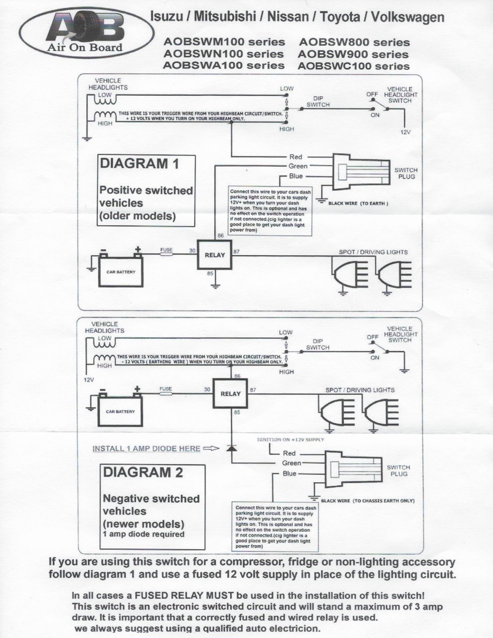

    2. When you moved to a five-tire rotation pattern (incorporating your spare), how did you handle TPMS since only four codes can be read by the computer at any one time? Does your tire shop swap out one of the sensors each time or do you have five sensors and they reprogram the computer each time?
    3. When you did Crom's ABS disable mod with the Air-On-Board switch, did you only connect two of the AOB wires (ground to ground, and tapped wire to trigger), leaving the other two terminated, or did you splice either of those others in somehow? Since no relay is used and the switch is unlighted, I'm a bit confused about how to proceed.

    I haven't had any issues so far with the stock boots. But I'm also a relatively low mileage truck (only just over 30K despite being a 2015) so it is quite possible they could go still!
    I don't do anything, nor do I think most people, which just means four times out of five the spare without a TPMS is actually spinning on a hub while a wheel with a TPMS is under the bed. The truck has no idea where the tires actually are location wise, so it doesn't care.
    Sadly it has been so long since I did the mod that I have no recollection of how the AOB switch is actually internally wired, but from the description in my write-up it sounds like I just figured out which two pins connected to the SPST switch and left the others unconnected since I wasn't going to fuss with trying to illuminate the LED.
    If you post a photo of your switch and any wiring diagram that came with it I can hopefully help you figure it out.

    Much appreciated, Ken! I'm going to get extended-travel CV boots, but I thought I'd see what your experience was with your stock boots... As for the TPMS issue, I'm hoping to figure out a fairly easy way where I'm always monitoring the four tires on the ground (and not the current spare), but I'll have to check around to see how best to do that.
    Below is the Air On Board wiring diagram that came with my switch (unfortunately, I've already placed the switch into my center console, so I don't have a picture of the switch harness). I'm assuming I can just connect the red wire from the switch to the tapped wire, and connect black to ground, while capping the green and blue wires. Do I have that wrong?

    @tacowhip12 best I can tell from the instructions what is actually going on is that the red/green wires are what are connected to the switch contacts. Blue is the 12V connection for the switch LEDs and black is the ground connection for the LEDs. So you want to connect red to the tap and green to ground. Leave blue and black capped if you don’t want to illuminate the LEDs. Connect blue and black as shown in the instructions if you do want them to illuminate.
    I’m pretty sure this wiring is different from when I did my install. They have this setup more intelligently than in the past so it can now have the LEDs function properly regardless of what you are connecting the switch to. In the version I had they tried to be too clever about minimizing connections and made the LEDs useless in a number of configurations.

    Thanks for your clear and concise explanation, Ken. I think I now understand what's going on a bit better... I have another AOB switch that I'm able to light up only when it's pressed (nothing is lit when dashboard lights are on), and I should be able to accomplish the same thing by connecting red and blue to the tap and green and black to ground.
